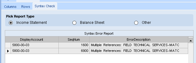

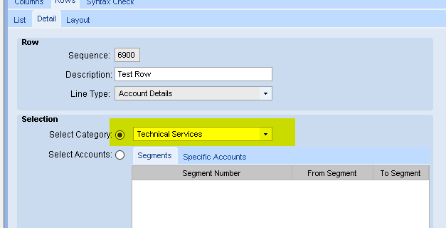

Having a financial Report row with Selection type Select Category: Tech Sales:

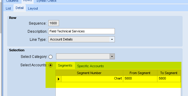

And another row of selection type Select Accts with some account details specified:
Will show as an error when you do a syntax check.
Note that error’s in the Syntax Check don’t prevent the Financial Report from running, but rather show that the output would not be accurate.
