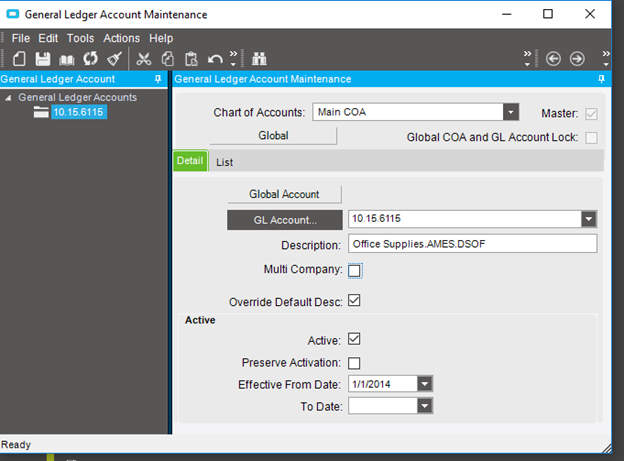

One is not the same as the others. Accounting is adding a new GL account number and the description in General Ledger Account Maintenance is not displaying and saving correctly. Anyone know why and how to fix it?
Adding other new accounts are fine, just this one seems to save incorrectly. We are on 10.2.200.10

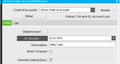

The GL accounts will default with EPICOR default of your dept or divisions segments included. In the GL set up you can check the Override Default Desc and that will get you what you need to fix it.

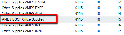

What happens is that when we first add the GL Account the description is incorrect showing AMES.DSOF. Office Suppliers. So we override the description to correctly say Office Supplies.AMES.DSOF.
I verify in GLAccount table in SQL description is correct.

Yes they do. Just this one is jumbled in the company.department.account format and not showing in the group. Strange behavior for sure.
