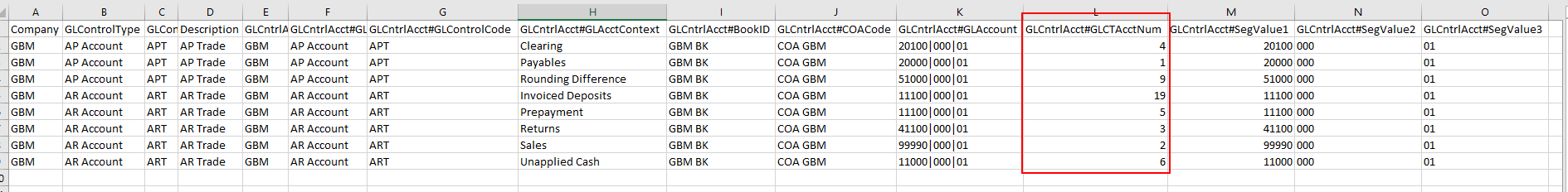

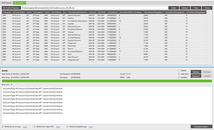

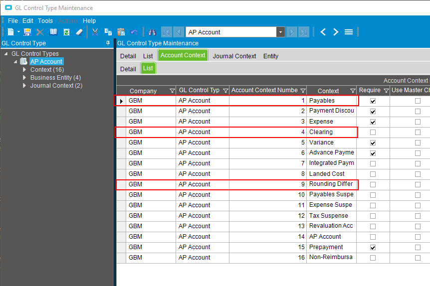

We are trying to import GL Control Codes. I am getting “GLCntrlAcct Not Found”. When I look at the error records and compare them to the GL Control Type the account contexts are there and the numbers match. I’ve also verified that the natural accounts I’m trying to set are there. Anyone have issues with this import working correctly?

I don’t think that error message is related to the GL Acct, as your DMT errored on #4 , but not #16 - which both specify the same GL acct.

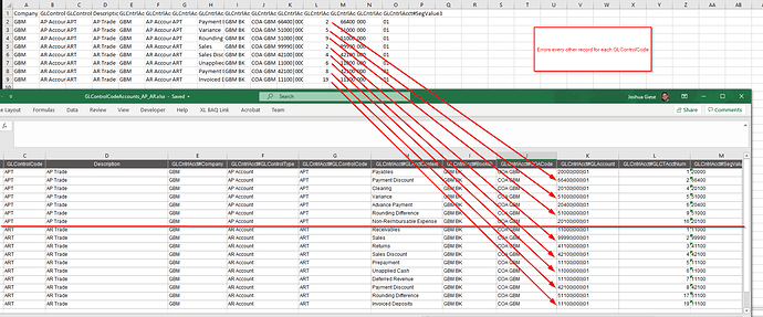

One other thing I noticed, is that it fails on every other - with a reset at change of GLC Code.
Your DMT order was:
APT 6 - Pass
APT 4 - Fail
APT 16 - Pass
APT 1 - Fail
APT 2 - Pass
APT 9 - Fail
APT 5 - Pass
< change of code>
ART 7 - Pass
ART 19 - Fail
ART 8 - Pass
ART 5 - Fail
ART 1 - Pass
ART 3 - Fail
hmmmm you’re onto something there with the every other. I can say it imports into my K2021 environment fine but not my 10.2.600.10 maybe a bug where something isn’t clearing between? I’ll try the numeric sort on account num but it shouldn’t matter. It doesn’t care what order you fill context IRL.
no dice on the sort but you are right every other for each code

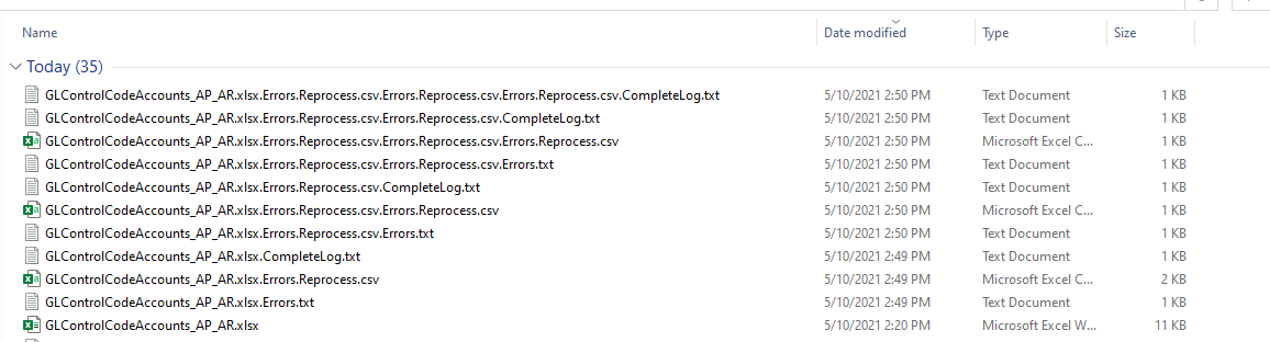

I’m thinking about just reprocessing the error files halving the total until nothing is left LOL
HA HA HA HA HA OMFG that worked. I just reprocessed until they were all in.

Contact support reference case CS0002567860 - or - DMT several times until there are no records left erroring out LOL. That’s what I did. Took 5 imports to half the records until they were all in.
