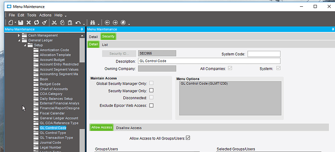

To answer your actual question.
The menu maintenance is where you go to set up the the security groups. Each menu is part of a security group (be careful with this because it seems like you are setting the security for a specific menu, but you are actually setting it for the security group that the menu is in. You may affect other menus). Usually the system is set up with a security group on a folder. If that folder is shut off from a user, they generally can’t get into the things within in. As you can see in the screen shot, the security group that is set up for the security control is set up to allow all users, but the group on the folders above it are only to the accounting group, so not everyone has access.
This is where you would set up access the specific users to have access to specific screens.
