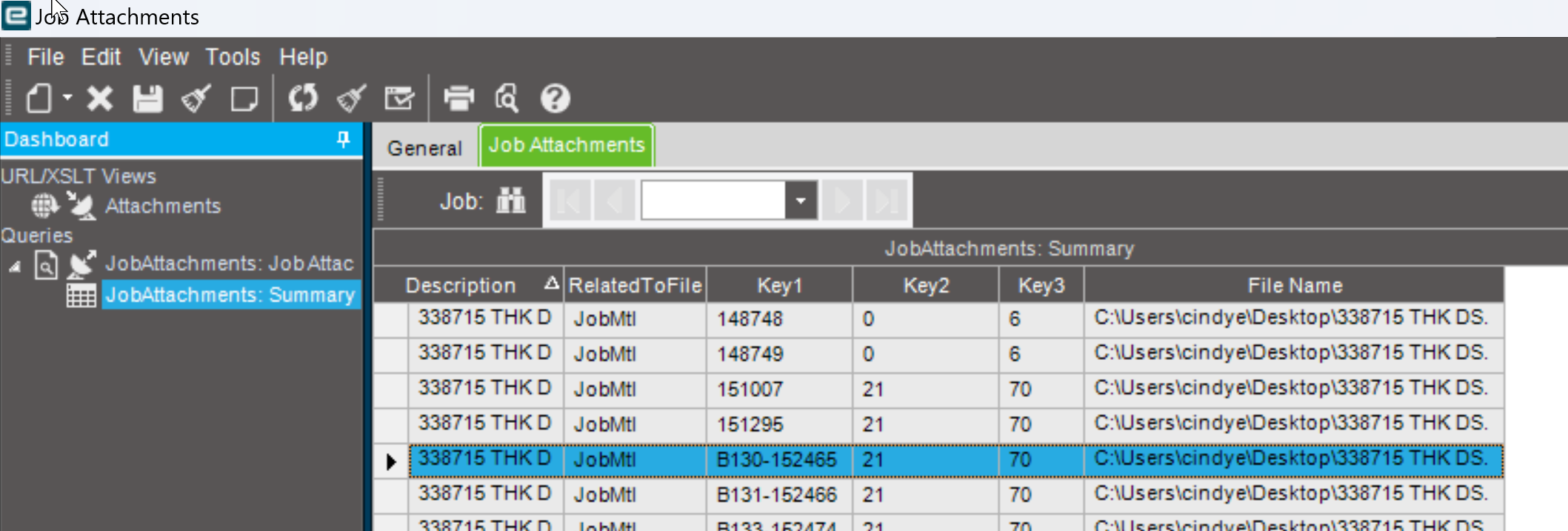

Back in the classic world where Epicor still works well I created a file viewer dashboard.
The columns that you see are job numbers, assembly and material. but more importantly is the file name with the path.

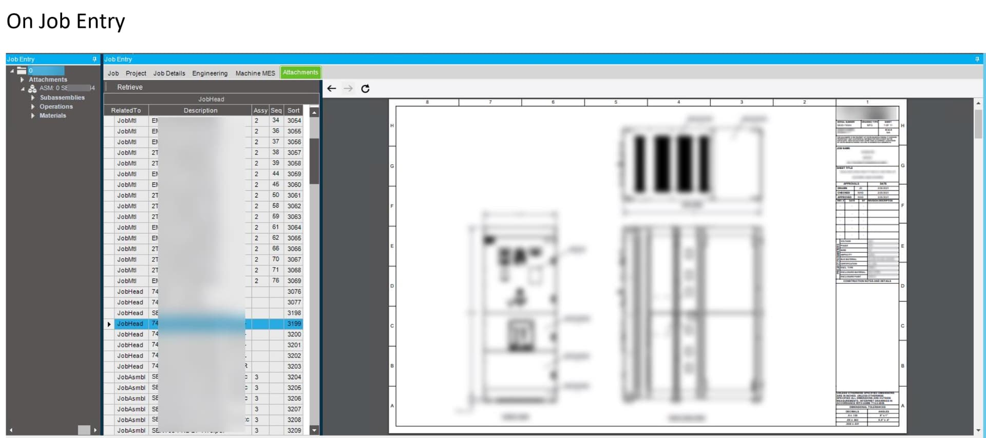

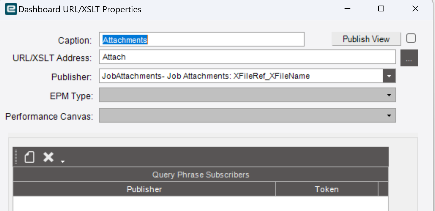

The other window of the dashboard (URL/XSLT view) was reading the filename into the view to display the file. This dashboard when embedded on job tracker or in MES would show the files for associated record very easily and quickly.
The finished customization last tab in Job Entry
