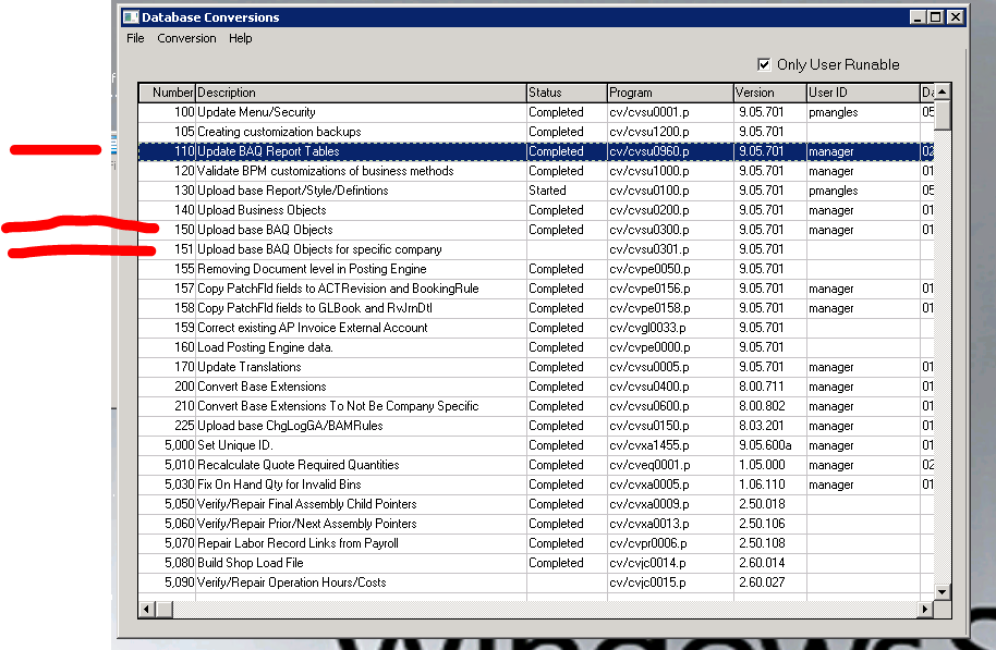

Unfortunately in 9 BAQs were actually copied to the other companies if I recall correctly.
You may have to go uncheck the global checkbox and recheck it. Just in case look in the admin tools and see if there’s a conversion
unticking global, clicking save and then ticking global and saving in original company didn’t work.
these 3 are the only ones i could find:
