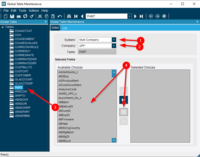

our global parts link fine however how can we get it so that in the child company when the global part is linked it carries over fields from the parent company
It’s a utility called “Global Table”:
  1. Select “Multi Company”. I’ve never seen “All Systems” work.
  2. Select the parent company.
  3. Select PART in the tree
  4. Select the columns you’d like to force to all the child companies and click the arrow to bring them into the Selected Choices box.
You will need to do this in all child companies. Keep in mind, once you do this you will have to update the parent company parts to push the fields to the child companies. This will also work for new parts moving forward. There is a checkbox in the part form that allows for “Global Lock”. If this is checked, it will ignore updates from the parent company. Make sure that is not checked in the child companies.
I second that. We have it set-up for All Systems and All Companies and it works. You make a change to the parent part and, when the Multi-Company Direct Server Process runs, it makes the same change in the child company. Fields selected there will become read-only in the child companies.

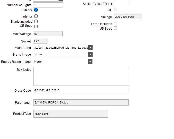

Hello i did what you said and now the child company fields are non editable I changed some details in the voltage field in the parent company and added -1 at the end I ran multi company looks like it ran but nothing changed
