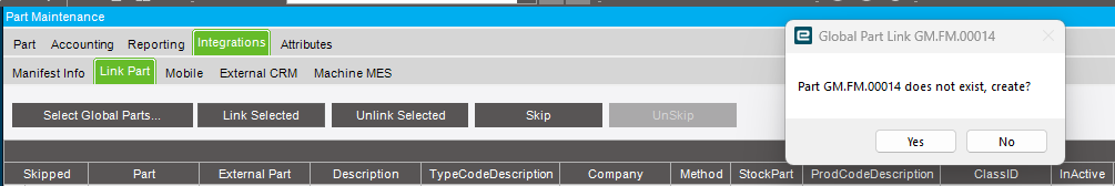

I’m in the process on making parts global for multiple companies, I’m able to add them one at a time with no issues and even found I was able to highlight multiple at once and select “Link Selected”.
However, I have a lot of parts that I need to add and I’m getting the pop up in the screenshot below for each part.
Is there a way to Link multiple/all parts at once? Currently I’m having to select “Yes” on that pop up for every new part I want to add and that’s going to take a while if I keep doing it this way. Thanks

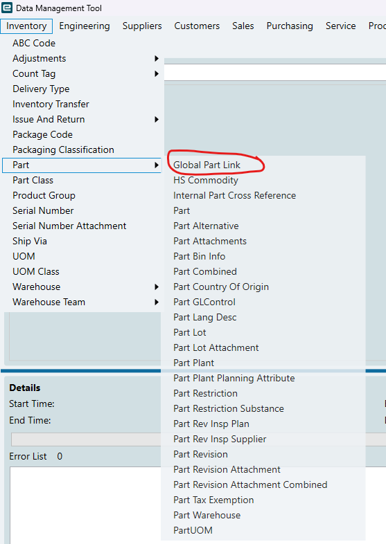

DMT would be nice, do you happen to know by chance what table/menu creates the part or replicates the “Link Selected” process on the integration tab of Part Entry?

  1. Part.GlobalPart = yes
  2. Run Multico
  3. This:
Fair warning it will balk if your product classes and groups don’t line up
Thank you @Conley.TUC! You just saved me a ton of time and headaches lol.
I tested a DMT upload on one part and it did indeed create it just as if I manually selected “Link Selected”.
