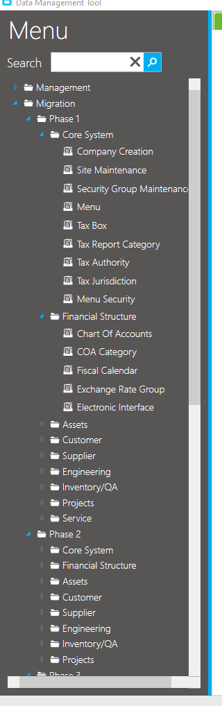

Do you have DMT?
I was given an Excel roadmap by our CAM a long time ago, but the roadmap was almost exactly the tree under Migration in the DMT. It was created by the same people.
[Edit] And I guess I forgot to add - I think they did a really good job with it. I used it as a guide when we brought another division into our ERP in 2020.

Yes, we do have the DMT and I think that will help. Thank you.
