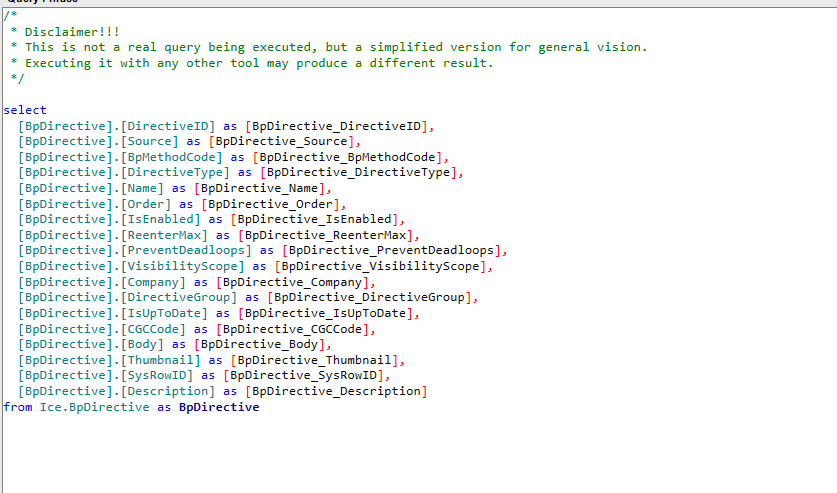

Wanted to lookup a list of directives, but the list doesn’t populate until you mouse over it.

It’s a column of data in your 3rd row there causing it. What does the query look like. Usually it’s data so large in a single cell that it breaks infragistics, or an image column.
It’s the BPDirective table with no criteria. There’s only 448 rows when ran wide open.
I changed it to show only those with IsUpToDate = false and that makes it only 11 rows.
Same performance.
edit it’s 498 not 448 wide open
If I specifically exclude that row, it still has the same performance.
Get rid of the thumbnail column to start
And the body row.
bup bup bup one change at a time @klincecum simmer down meo.
@TDray he’s right though that’s the next column if it still does it.
I removed the thumbnail and it still had the same performance.
Removed the body column and it fixed it.
