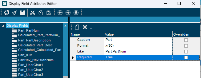

I’m having some trouble implementing right-click “Open With” on Kinetic grids that I’m populating manually with rest-erp (which is the majority in my custom application, unsurprisingly). Having the “Like” set in the BAQ Attributes editor seems to have no effect, even for native fields (not just calculated columns).

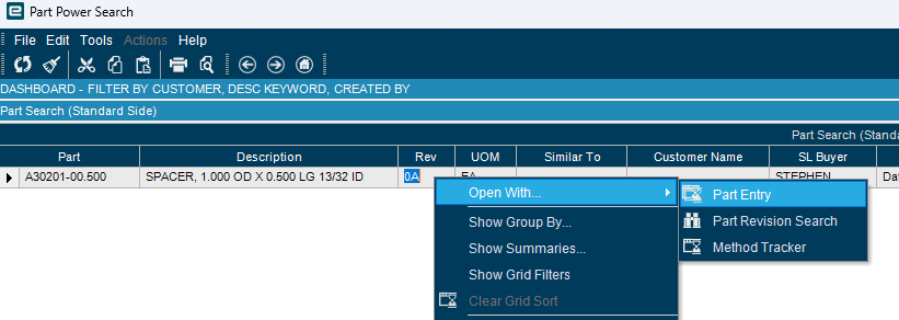

For comparison, the right-click on the classic version of this dashboard works fine.
