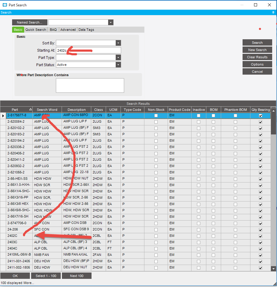

Grid sort on search ( Part)
I have an open call with Support and I saw the same issue on 10.1.500.16, now on 10.1.600.22
When I enter a complete PN in the search, I expect it to be the first on my list. On certain PNs this is what I see.

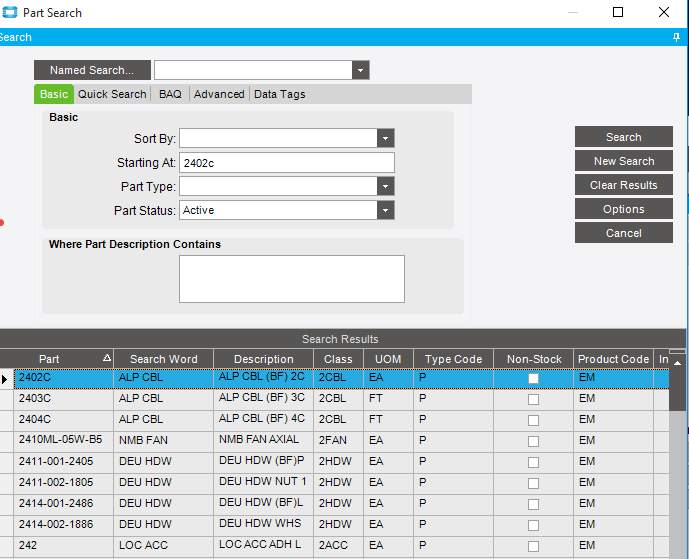

As you can see on the second image (e9.702a) it is working as expected.
Anyone seeing this?
Here is a suggestion from support, but my default is set to StringSort
