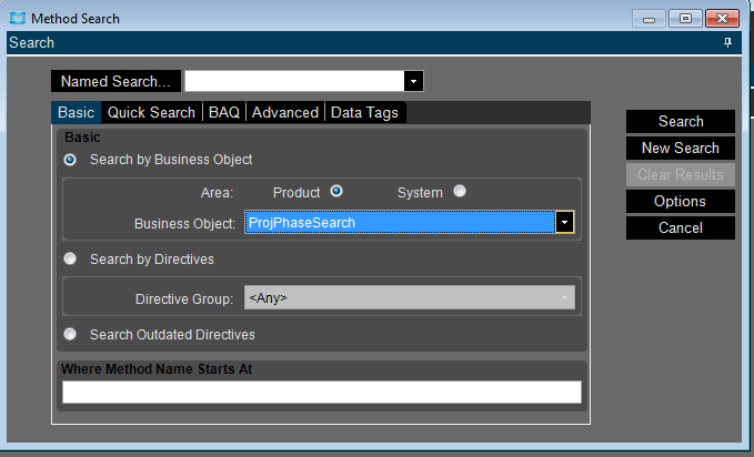

Thank you for the tips. I tried the pop with Erp.Project.GetByID, and it is popping. I think the issue, is that I am not getting the right table/method for the WBS Phase–>WBS Phase Costs area.

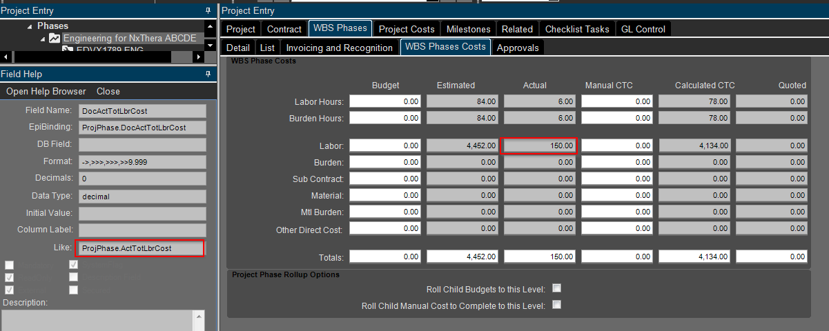

The highlighted indicate it’s from ProjPhase.ActTotLbrCost as well as ProjPhase.DocActTotLbrCost.
Only one I found is the ProjPhaseSearch, but none of those methods are triggering anything.
My BPM is pretty simple, that if the field is greater than 0 than display true else false.
