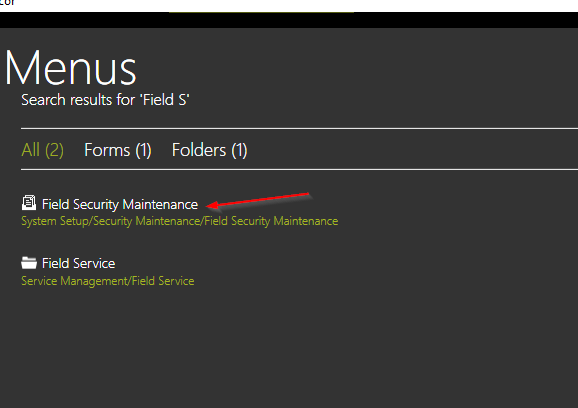

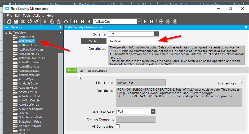

Anyways, I did look at the Field Security maintenance for other field security access. It doesn’t seem to be working with my testing. We are on 10.2.100.7.
Below is what I did:
- Open Field Security Maintenance.
- Schema is ERP
- Table select ProjectCst
- Select the field, in this case it’s TotActLbrCost
- From Detail tab change the “Default Access” to None.
- Check “All Companies”.
- From Users/Groups select the group and select default to “None”.
Once that’s done, I create a test user and assigned the user to that group that is supposed to have no access to TotActLbrCost. Signed out and in as that user. I can still see the TotActLbrCost.
So not sure if Field Security Maintenance works in this version or I am not doing something right.

Is your test user a Security Manager? Security is not applied to Security Manager users.

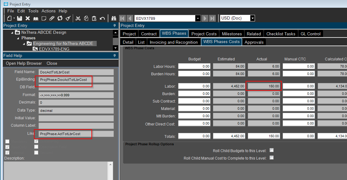

So I want to set the highlighted to zero. The EpiBinding is DocActTotLbrCost.
I did a Post Method Directive for GetByID, and set the field to more than 0. However, I am putting a message just to have it pop up if the condition DocActTotLbrCost is more than 0. It doesn’t seem to be doing anything. Anyone see anything I missed?
Does it fire when you bypass the condition?
Also, I don’t think a GetBy is going to have changed row, it’s not changing anything, it’s just getting things, so that might be messing you up.
Correct no changed row in GBI, use AnyRow
A good way to test those is to also add a pop-up message to the false side. Make sure you can tell the difference between the two pop-ups. Then in both, do a table query to see what is being passed. Make sure to grab the RowMod if it’s available. That will help you figure out a lot of things much faster.
