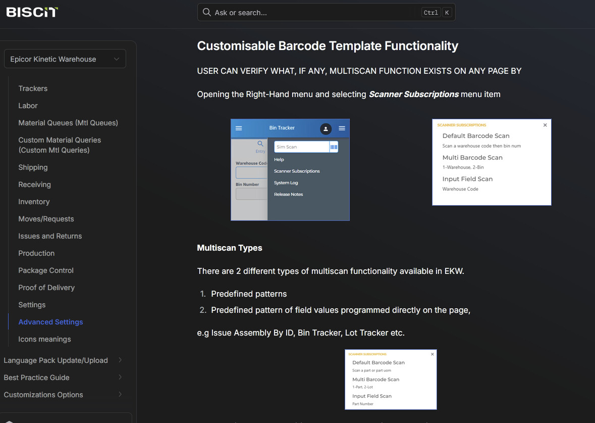

Biscit has their help files open to the web, so you can go here and there is a bunch of information. The Barcode template information that you are looking for is here.
One thing I will note, is (I believe, I actually could be wrong reading the doc now) that the multi field scan template is screen specific and not universal, so it doesn’t work everywhere. So if you’re having issues finding the settings for whatever you are doing, make sure that the screen you are trying to set up supports multi field barcodes. But that’s just been our experience, although we haven’t dug into it that much.
