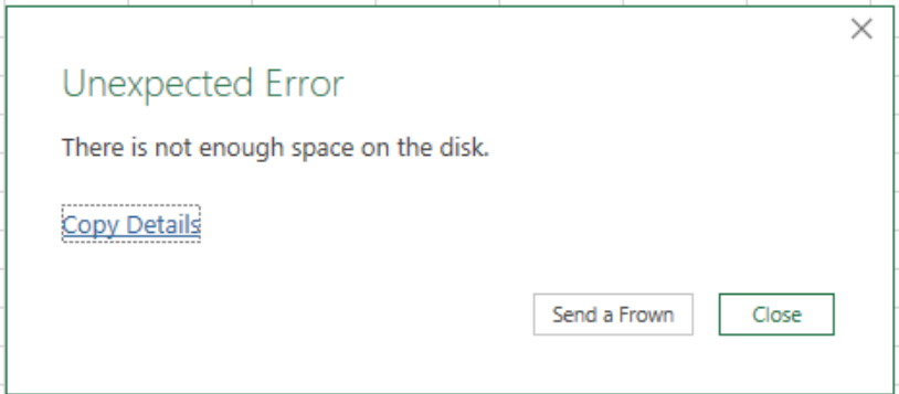

I was thinking I could use REST to download the raw data to Excel and let Excel do the heavy lifting. But…
I can recreate this in SQL and use a direct SQL connection, but that bypasses a lot of security (and possibly features).
Does anyone have any good ideas here? I am thinking about:
  1. Compression of the REST data
  2. Utilizing Paging
  3. Pulling out my hair
