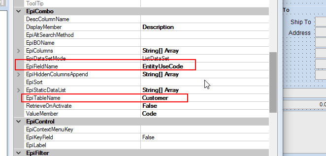

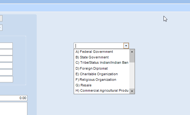

by the way this is a little known fact but a lot (most) of “Static” combos in Epicor are populated this way and its built in to the EpiComboBx you just have to populate the EpiFieldName and EpiTableName and populate that CodeDescriptionList in zDataField
Set retrieve on Activate to False and Epicor will “automatically” lookup and fill these combos for you. And yes it works on UD fields too
These values are stored tilde separated with a back tick between the value and the description such as
S`Supplier~CU`Currency~GL`GL Account~SG`Supplier Group~AD`Apply Date~I`Invoice~OT`One
Time
