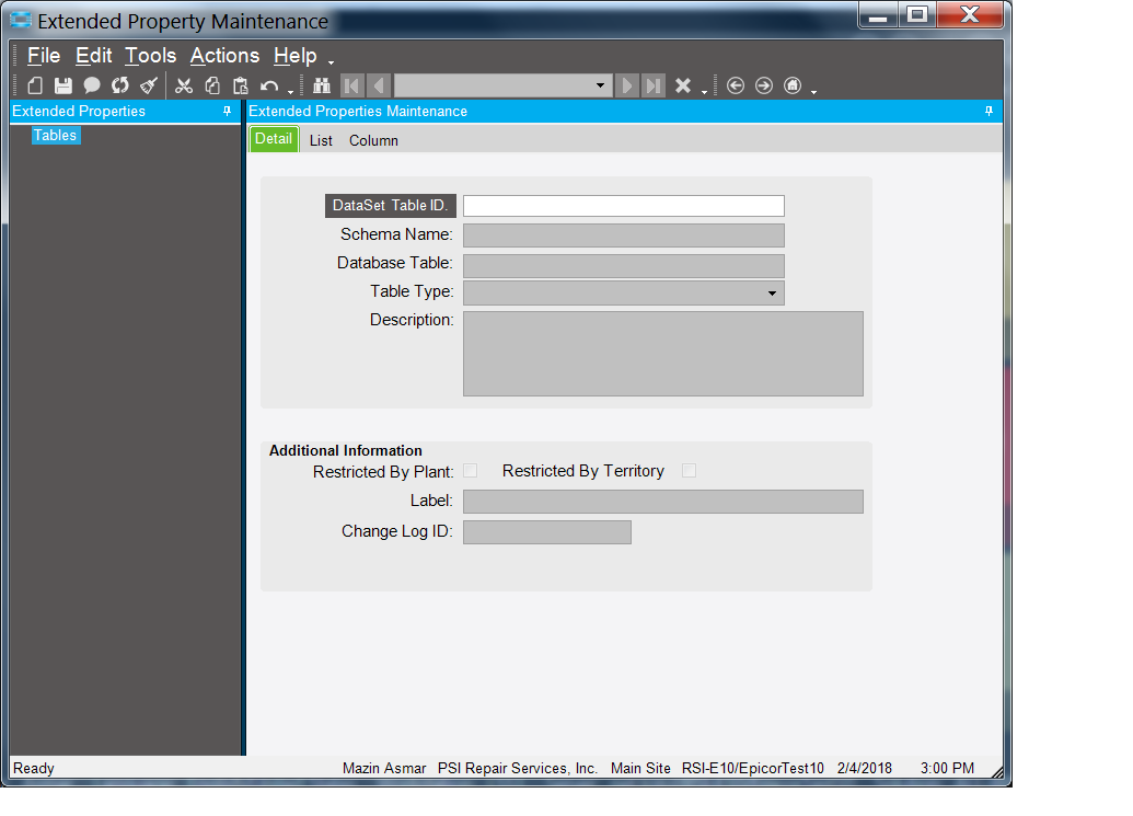

If an error occurs while during the DB gen it will not be displayed in the EAC. To check if the UD field was removed successfully, you will need to use the Extended Properties Maintenance to verify the UD field has been removed. If sessions are open to the target table the UD field will not be removed. As an alternate option, terminate all connected session by restarting IIS.
