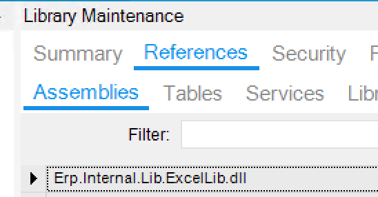

You will need the following reference in your library:

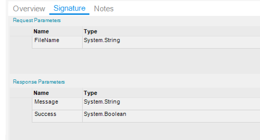

Create a new C# Epicor Function with the following parameters:
FileName should be the full .xlsx file name (e.g. ExcelFile.xlsx)
