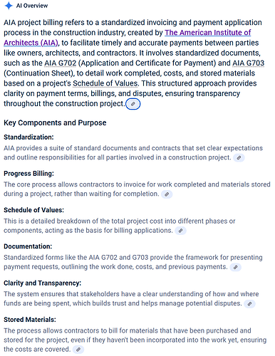

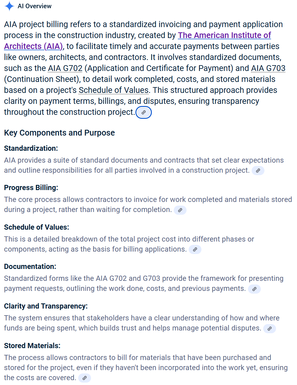

Google AI says this about what AIA Project Billing is:

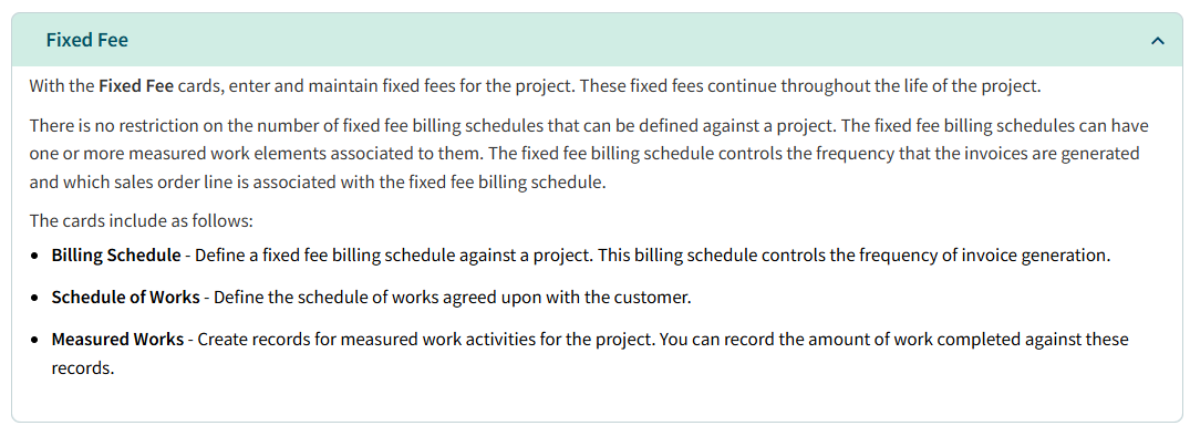

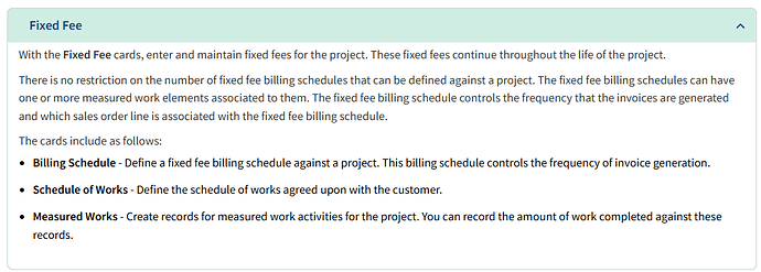

Our situation was simpler but I wanted to use the “Construction” style of billing, or Fixed Fee.
This is where a SOV would be. Our billing schedule was simple - 90% down, 10% at completion. There were sign-offs for each schedule of works and that defined revenue recognition.
