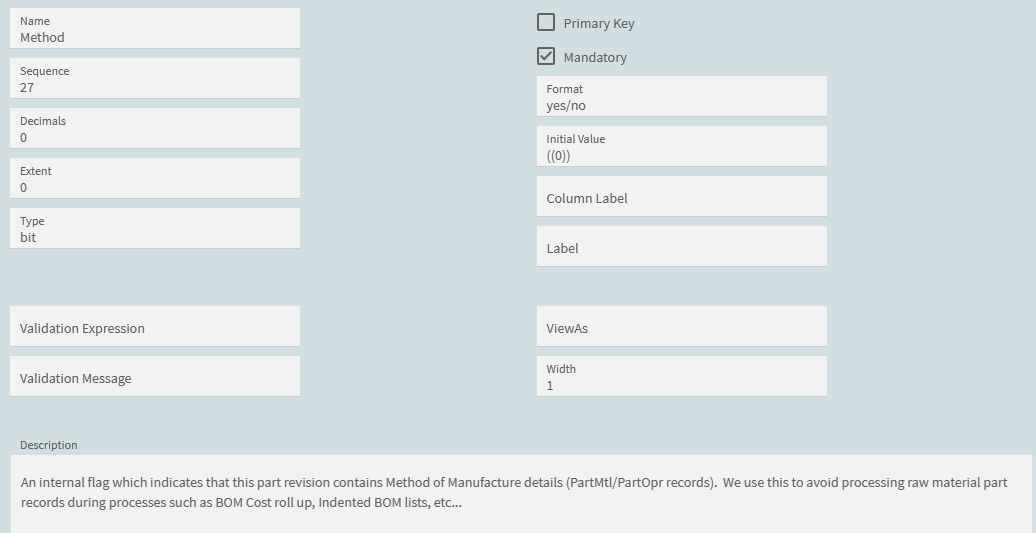

Since Vantage, PartRev.Method is true if there is a method.
