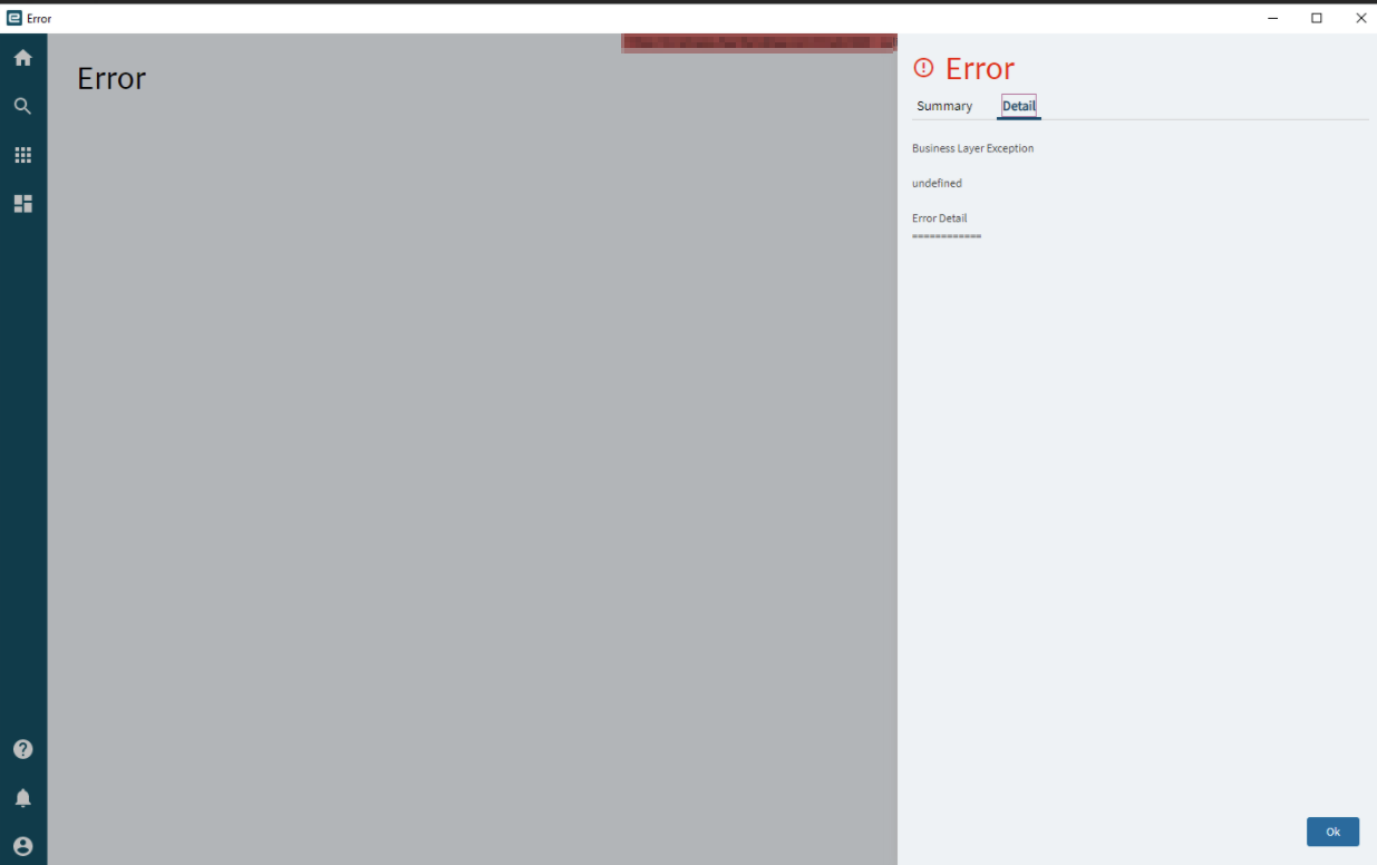

We use the kinetic version of order entry and have a custom layer attached. All of the sudden nobody could open order tracker this morning (it was working fine at 8pm last night).
No errors in the server log. There was an unidentified ASP.net 4.0 error showing up in the event log but it didn’t tell me anything.
I tried previewing my layer from application studio and it worked fine. So I republished it which solved the problem.
But why did this happen? Why would a customization that has been working fine for months suddenly break completely and totally for everyone with no changes at all? Servers not updated or restarted recently, literally nothing has changed.
It makes me feel really uneasy about the stability of kinetic - what if I took vacation? Just nobody use order entry until I get back?? I don’t have much confidence that Epicor support would have solved this issue in under a week, if ever.
