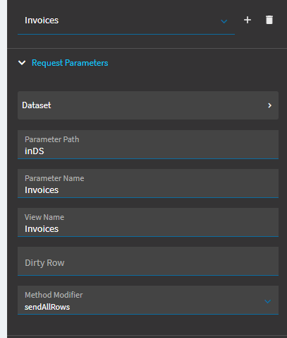

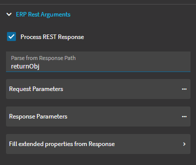

I’m trying to pass a DataView to a function within an event via the erp-rest widget.
When I execute the event, it doesn’t appear to call the function as I have a StreamWriter in my function to monitor execution.
My function takes an input parameter, inDS, that is defined as a DataSet.
Here are images from my rest-erp widget configuration:
My DataView’s name is Invoices
I have an API key and ERP Functions library defined in the Call Options section as well.
I do not see this API call in the browser’s network tab when executing either, so I cannot check the payload.

When i attempt to use the erp-function widget I am able to see the function being executed, however the dataset is not being passed properly and comes through as null.
The solution to my issue was that I didn’t have my data view in the Dataset Id field
Once I added this, it started working properly.

Turns out my issue in the end was that I clicked the dataset button which broke my rest-erp widget.
I had to delete the widget and recreate it, then everything started working.
