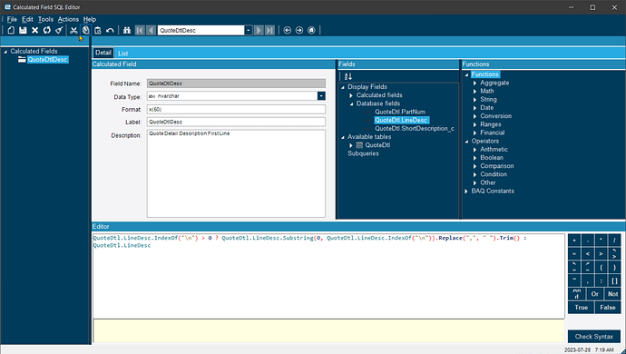

When I check syntax, I get this error.
I tried replacing the double quotes with single quotes, as I saw that somewhere. Thanks for the help. I’m just a noob trying to get started!

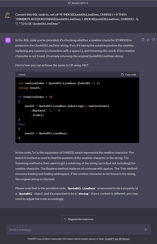

hold i goofed that up but I made the chat bot apologize for my transgressions

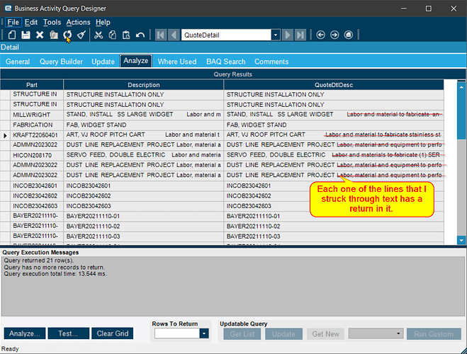

This is getting closer. (the syntax checker liked it, and it tested without error.)
However, I wish to only return the description up to the first carriage return if a carriage return is present.
for example, for this description since there is a carriage return after the word CART, I would only want the first line highlighted. Otherwise if there isn’t a return, then the result should be the entire description. I will use the charachter limit to trim the overall length x(50)
