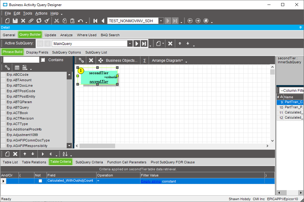

I tried doing a filter null constant and a filter Empty string constant.
The null returned 0 rows
The Empty string wouldn’t run. It gave: Criteria value is not defined for ‘secondTier’ table, in criteria row #1. Select filter value from the dropdown and click on links to specify filter conditions.
I have the Top Level called MainQuery
I have innersubquery called secondTier the links the next 2 queries together and gives the null fields I need.
I have innersubquery called PartsWithADJ that filters like it sounds.
I have innersubquery called PartsWithOutADJ that filters like it sounds.

A possible problem might be the filtering on an internet (or decimal) for an empty string. Since it’s not a string. Try filtering on the part number filed instead of the counted field.
