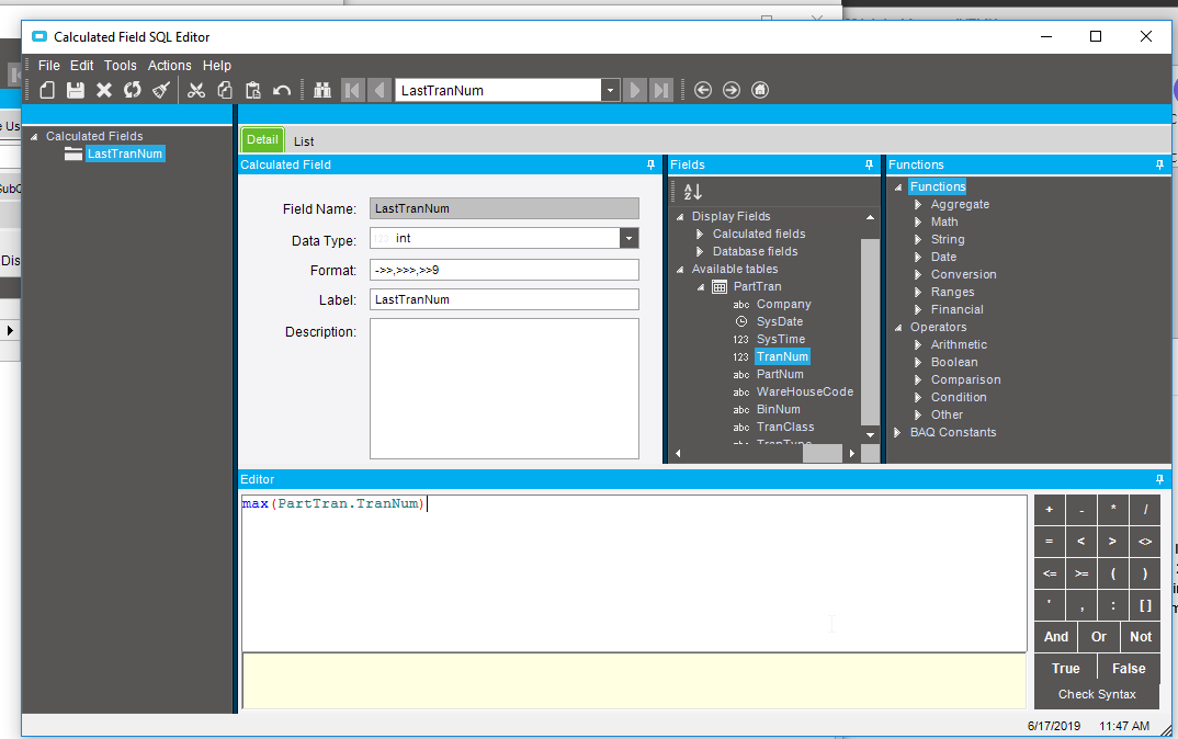

Right now I use a subquery that return the max(PartTran.TranNum).

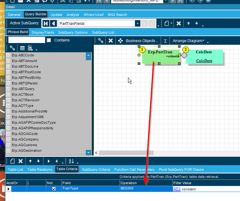

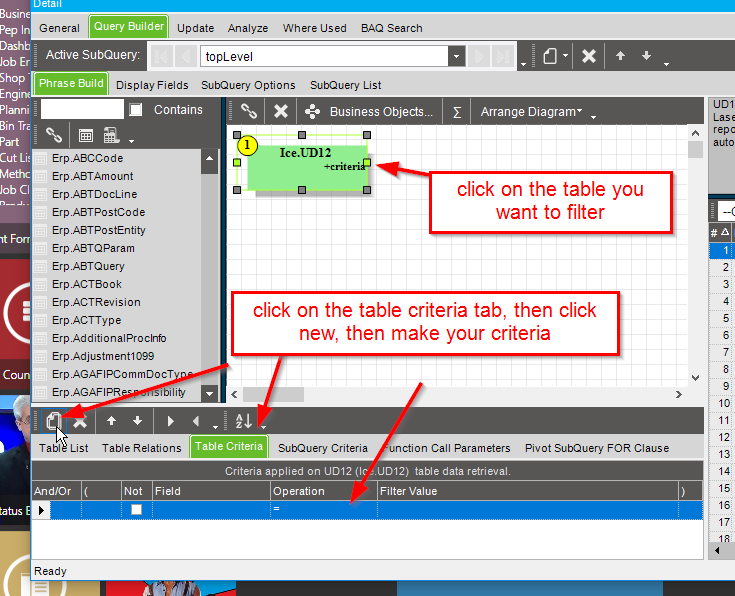

In your subquery, just put a filter on the part tran table. You have to put that on in the design canvas of the tables, there is no way to do that in the calculated field (that I know of)
I misunderstood by what you meant when you said filter.
That was the 1st thing I tried. My calculated field only returns the max(TranNum) so if I filter it here, it totally removes the part from query.

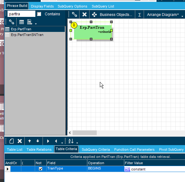

So the first thing you’ll do is bring in the PartTran table and filter like so.
Also, this leads me to believe that you are just filtering on the wrong level. You need to filter the PartTran table in the subquery, not the subquery in the top level, and not in the subquery criteria.
