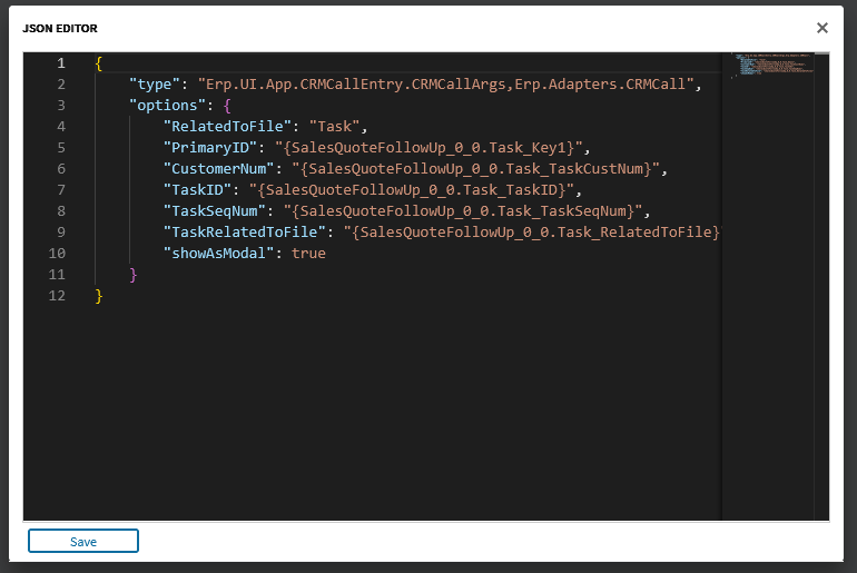

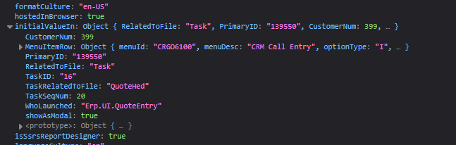

I wanted to use the app-open widget to open the same call log window that is opened if you click on the call log in the quote entry screen. So I went to the call log tool event in application studio:

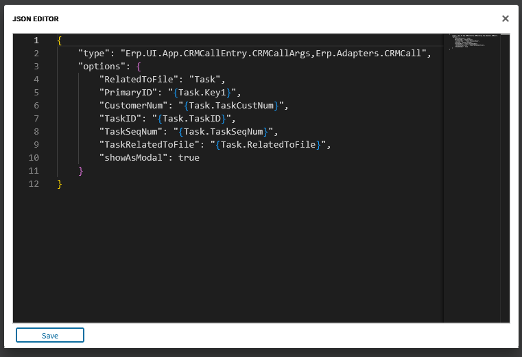

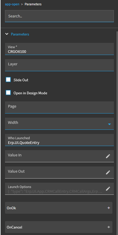

I then when to my event and application studio and made it the same:
and I can see the data comes over in the debug:

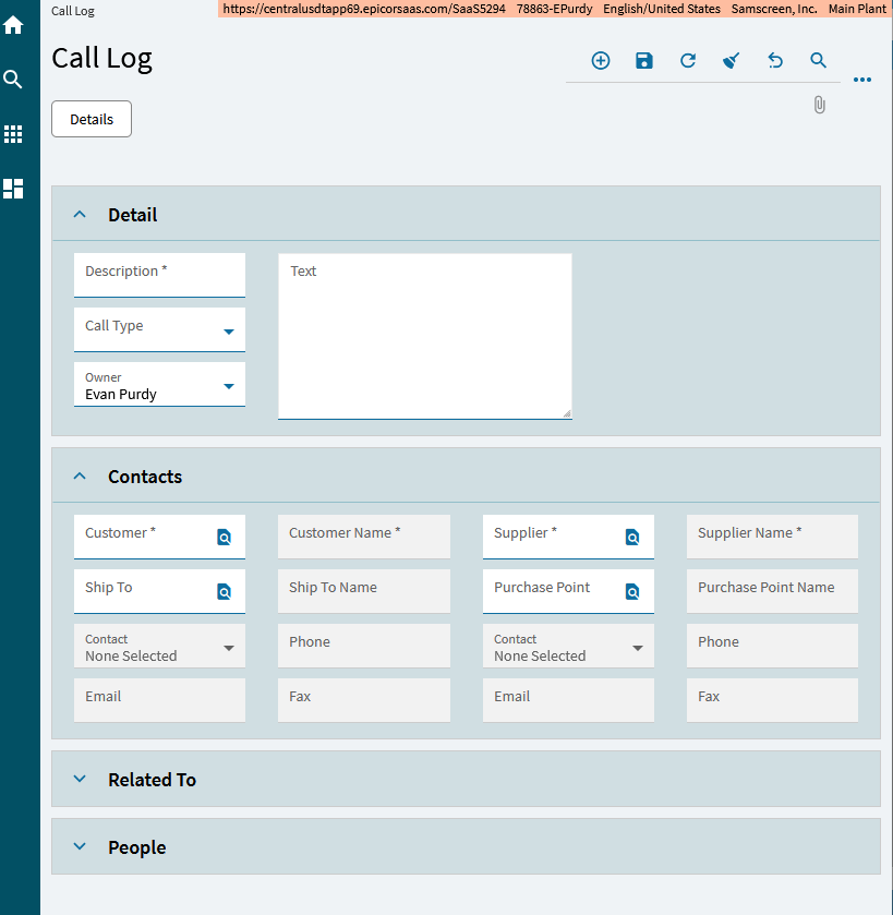

But the wrong window appears, and no data is preloaded. This is the call log UI my event brings up:

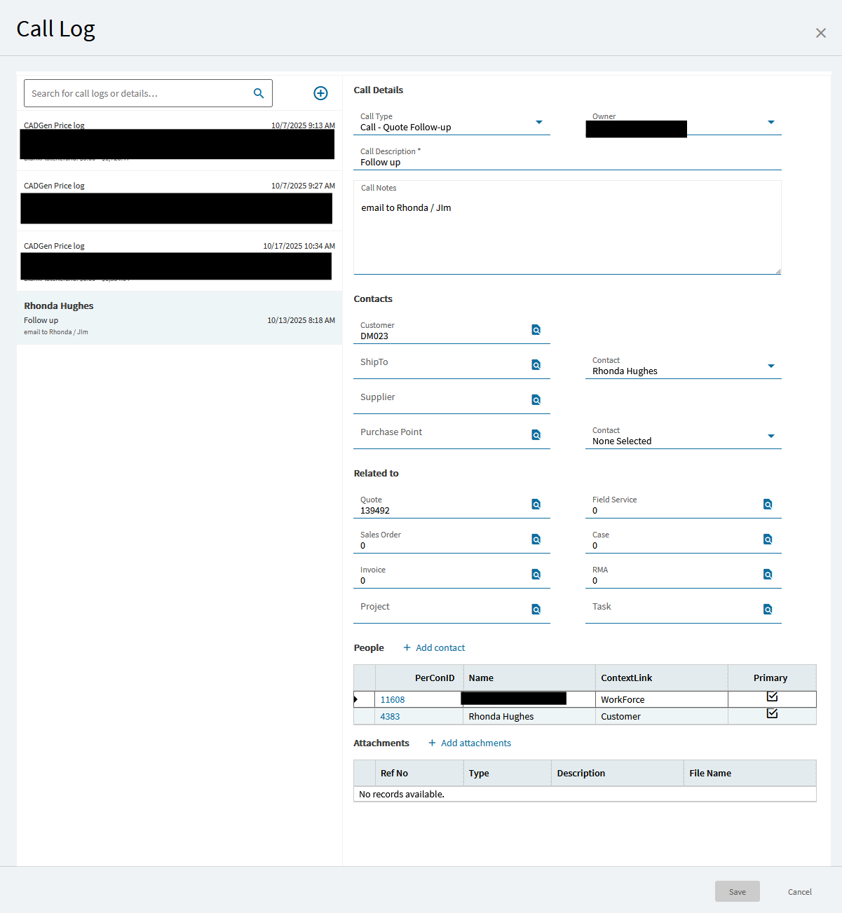

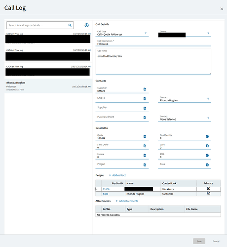

but this is the UI that appears in quote entry and is what I want:
Its the same Menu ID and same inputs.. what is this insanity?? Only think I can think of is there are multiple call log things in quote entry and I found and copied the wrong thing??
