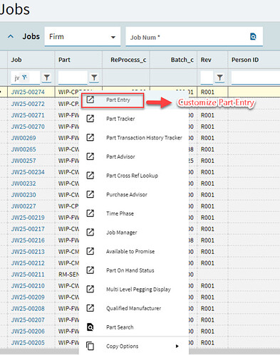

Help me, I want to change the Context menu to Customize form, how do I do that?

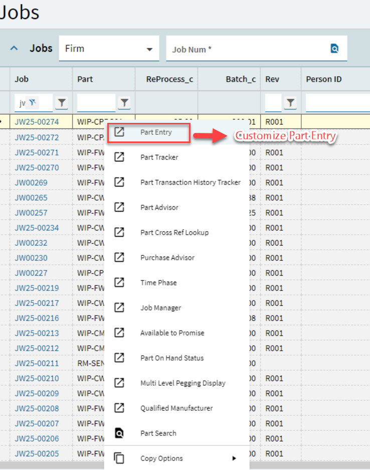

In order to get to your customized form, you would have needed to copy the “Part” menu to your current company in Menu Maintenance. At that point you would’ve needed to give that new (copied) menu a “MenuID”.
Find the MenuID for your customized Part Entry form in Menu Maintenance.
Armed with that… Go into Context Menu Maintenance.
Open up the context menu for Part.PartNum
Click on the Part Entry menu item.
Change the Process ID from the stock Menu ID to your custom Menu ID.
That should get you where you want to go.
