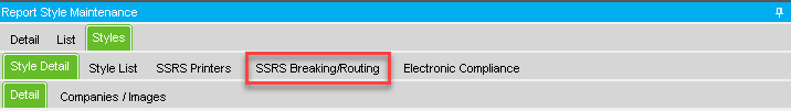

Do you have SSRS Breaking / Routing? That can be configured to sends an email
@Mark_Wonsil Was not in a widget unfortunately but that BAQ is nifty so thank you very much!
@johndack We do have that but I looked at the PackSlip report styles and none of them have any APR setup.
