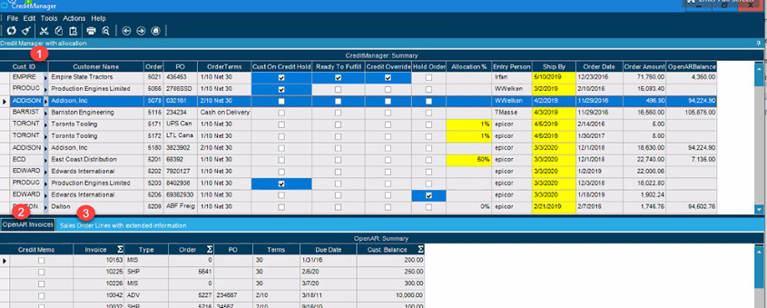

My go to has always gone to a status dashboard. Emails get buried, and forgotten.
What your describing is one that when customer are paid up on their order, override the credit hold on the order, don’t take the customer off hold.
The dashboard has indicators that of a status of the customer credit, the order hold(s), and invoices paid on the order. It is also showing the status of the complete pipeline.
See attached for details.
Credit ManagerDashboard.pdf (913.6 KB)
