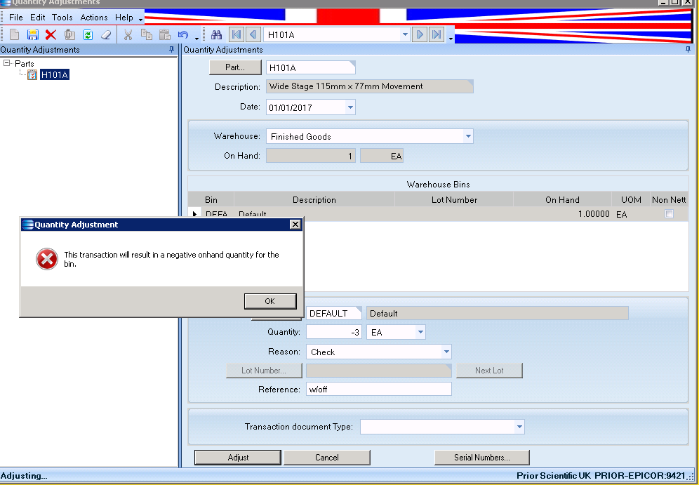

If i manually try to reduce stock lower than the on hand quantity, i get an error message as per the screenshot below. Which is great.

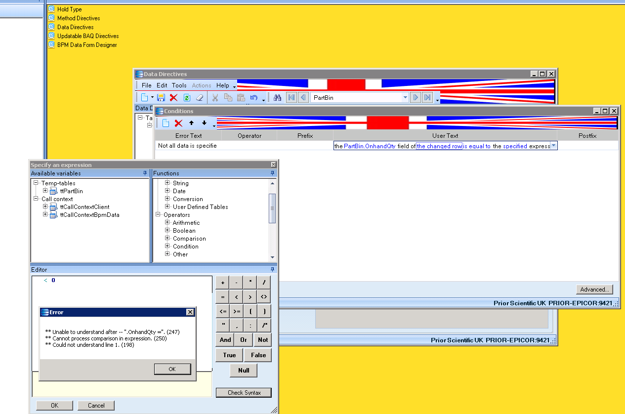

How do you write less than 0 in the epicor syntax?!
Does your BPM not need to say ‘less than’ the ‘specified’ rather than ‘equal to’?
your quite right,…that gets me past the syntax problem.
Thank you.

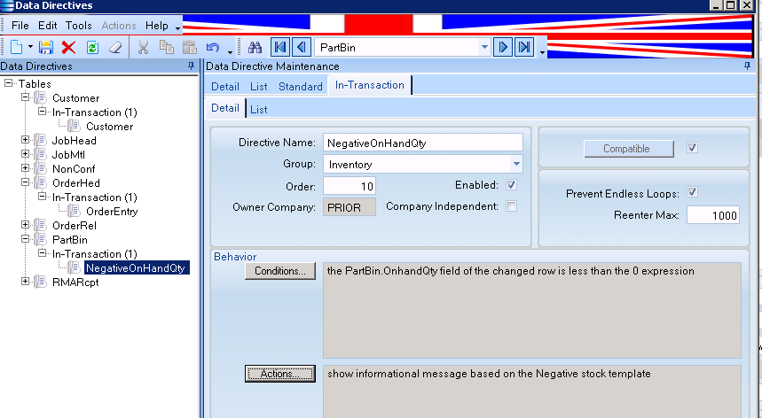

1 last question, should it be “changed row” or “updated row”?
I would use updated row first.

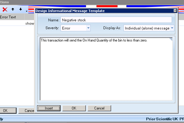

I have noticed though that you are only showing a message rather than having a stop exemption, is this only for your testing stages?
Hi Neil,
the “information” message is a severity of “Error”, which i think does stop the process rather than just an information message.
That is a fair point Mark, hope it all works for you.
Thanks Neil
I need to revisit this…the “error” message appears when you go less than zero, but it doesn’t prevent the transaction from happening. Its almost like its missing a STOP action of some kind.

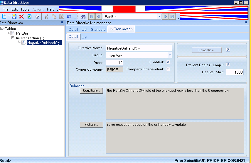

ok, this seems to do it…instead of “information message”…i used "raise exception
