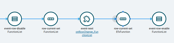

Put a event-column-disable component before your update, input the DataView into “DataTable”, and drop an event-column-enable after.
Something like this, but this is to block a row changed trigger vs. a column changed:
It will stop the onchanged event from triggering.

I encase the row-update in the Window_OnLoad with a event-row-disable and an event-row-enable?
Yes, that’s correct. Put a disable just before the row-update, and an enable just after it. Naming the correct DataView/Column in the enable/disable components.
