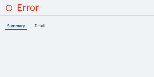

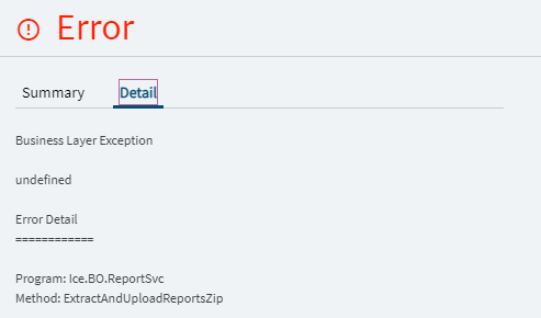

I have edited the SQL of the dataset to include the new field and added it to the field list, but when I try and import my report to Epicor it fails.
Any suggestions?
what’s the error?
Well that’s super helpful. :roll_eyes:
My thoughts exactly. Epicor support couldn’t offer much advice either.

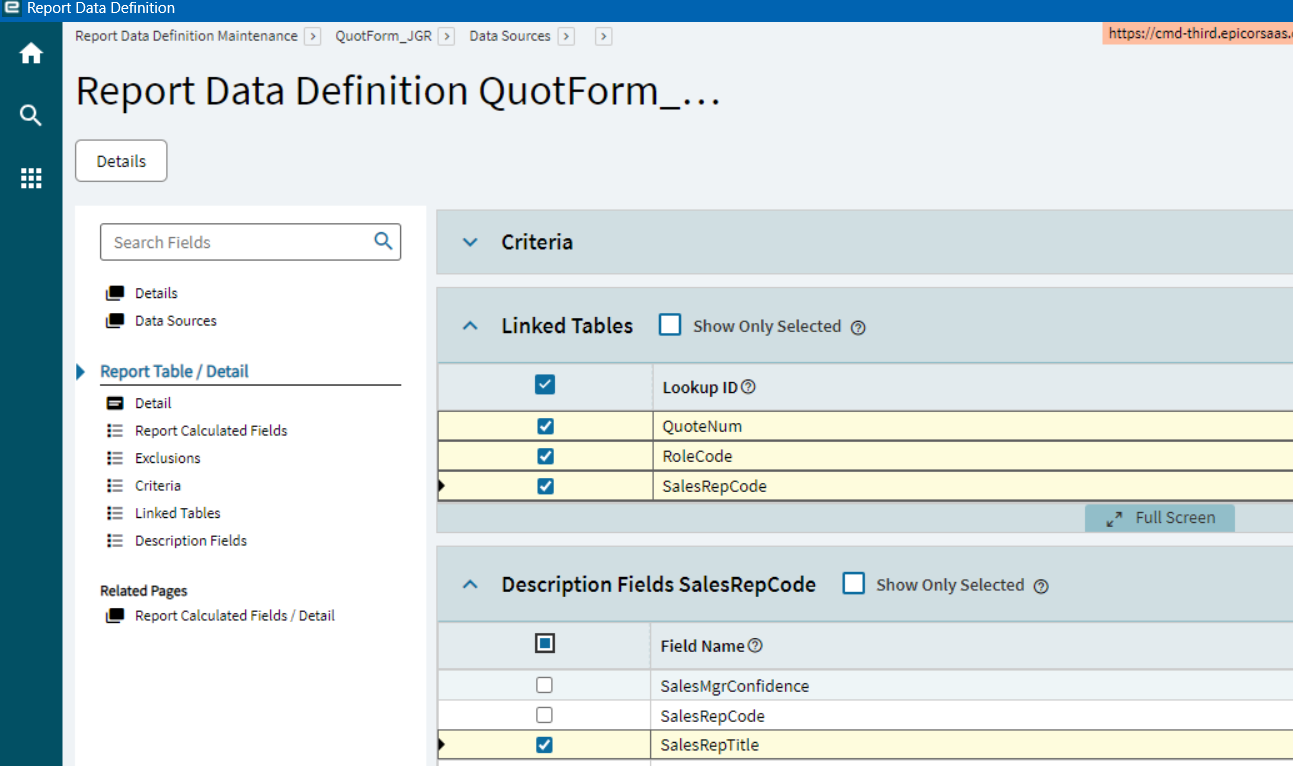

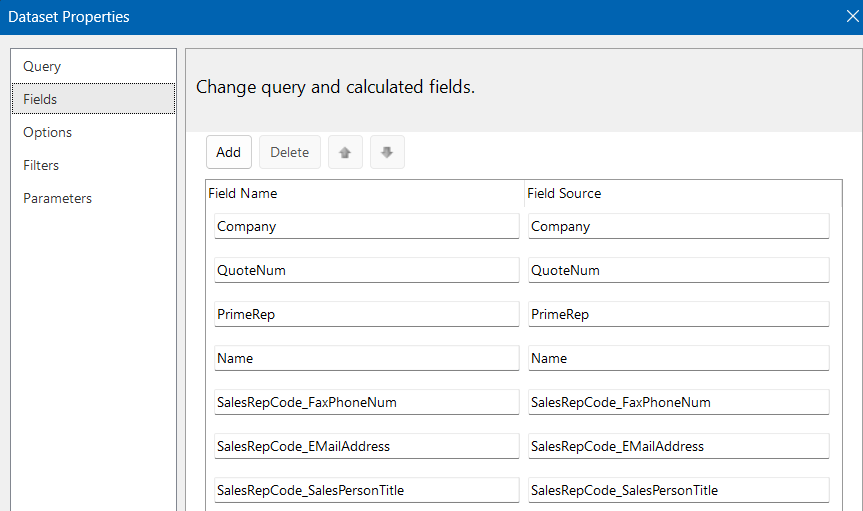

Below are screenshots of my Report Data Definition and SQL Query

from the data definition screenshot it looks like you need to change
T1.SalesRepCode_SalesPersonTitle to
T1.SalesRepCode_SalesRepTitle
Agree @zwilli526 think his DS Expression should be:
You would also need to update the column names {Field Source/Field Name (if desired)} looking at the image.
