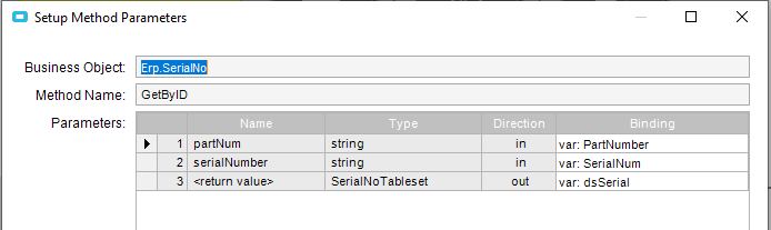

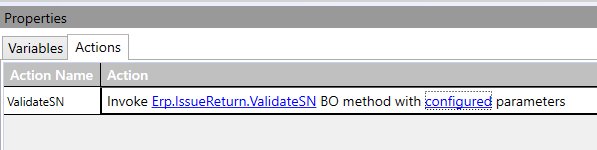

I have not done what you are attempting, not to that level of complexity. But we do issue serial numbers via an Epicor Function (basically a BPM).

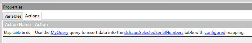

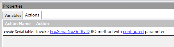

What I have is
  1. Invoke BO method:
  1. Fill Table By Query:
  1. And Invoke BO method (because I guess you are supposed to?)
Well… among many other steps (like quantity and from-warehouse/bin, etc.), but you were asking about serial numbers specifically.
This is very helpful though, thank you! :slight_smile:
This is starting to ring a bell now - I remember thinking the same things.
Yeah, despite those “add” methods, none of them seem to work. You actually have to create the table yourself from scratch - that’s the fill table by query widget.
I only do one serial per transaction, so GetByID works for me. But I would assume :crossed_fingers: that GetRows could work too, if you are doing multiple?
Yeah I am now stepping through a trace when I assigned serials manually to a job to see all the BOs it invoked to see the process. Fun thing is my situation could be one or many depending on how the job was setup.

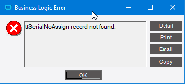

I appreciate both of your responses! I’ve gotten pretty far, but when I run the following code:
  string oprCmpWarning = String.Empty;
  serialNoAssign.SetSerialNoAssign(ref serialNoAssignTS, false, out oprCmpWarning);
I get “ttSerialNoAssign record not found”
Here is the full JSON formatted version of serialNoAssignTS, and as you can see I have the SelectedSerialNumbers populated, no data seems to be missing so I’m lost as to why I am receiving this error. Thank you for the help!!
{"SelectedSerialNumbers":[{"ColumnNames":0,"Company":"401","SerialNumber":"203-180066","Scrapped":false,"ScrappedReasonCode":"","Voided":false,"Reference":"","ReasonCodeType":"","ReasonCodeDesc":"","PartNum":"N00983203-1","SNPrefix":"203-1","SNBaseNumber":"00000000000000080066","SourceRowID":"9f655539-5fc7-452e-8056-38f96aaef0ce","TransType":"","PassedInspection":false,"Deselected":false,"KitWhseList":"","RawSerialNum":"203-180066","KBLbrAction":0,"KBLbrActionDesc":"","PreventDeselect":false,"XRefPartNum":"","XRefPartType":"","PreDeselected":false,"poLinkValues":"","SNMask":"","NotSavedToDB":true,"SysRowID":"00000000-0000-0000-0000-000000000000","RowMod":"A","SpecifiedProperties":"////Dw==","UserDefinedColumns":{"ColumnNames":0,"RowSelected":false,"SpecifiedProperties":"Ax8xEg=="}},{"ColumnNames":0,"Company":"401","SerialNumber":"203-180067","Scrapped":false,"ScrappedReasonCode":"","Voided":false,"Reference":"","ReasonCodeType":"","ReasonCodeDesc":"","PartNum":"N00983203-1","SNPrefix":"203-1","SNBaseNumber":"00000000000000080067","SourceRowID":"9f655539-5fc7-452e-8056-38f96aaef0ce","TransType":"","PassedInspection":false,"Deselected":false,"KitWhseList":"","RawSerialNum":"203-180067","KBLbrAction":0,"KBLbrActionDesc":"","PreventDeselect":false,"XRefPartNum":"","XRefPartType":"","PreDeselected":false,"poLinkValues":"","SNMask":"","NotSavedToDB":true,"SysRowID":"00000000-0000-0000-0000-000000000000","RowMod":"A","SpecifiedProperties":"////Dw==","UserDefinedColumns":{"ColumnNames":0,"RowSelected":false,"SpecifiedProperties":"Ax8xEg=="}},{"ColumnNames":0,"Company":"401","SerialNumber":"203-180068","Scrapped":false,"ScrappedReasonCode":"","Voided":false,"Reference":"","ReasonCodeType":"","ReasonCodeDesc":"","PartNum":"N00983203-1","SNPrefix":"203-1","SNBaseNumber":"00000000000000080068","SourceRowID":"9f655539-5fc7-452e-8056-38f96aaef0ce","TransType":"","PassedInspection":false,"Deselected":false,"KitWhseList":"","RawSerialNum":"203-180068","KBLbrAction":0,"KBLbrActionDesc":"","PreventDeselect":false,"XRefPartNum":"","XRefPartType":"","PreDeselected":false,"poLinkValues":"","SNMask":"","NotSavedToDB":true,"SysRowID":"00000000-0000-0000-0000-000000000000","RowMod":"A","SpecifiedProperties":"////Dw==","UserDefinedColumns":{"ColumnNames":0,"RowSelected":false,"SpecifiedProperties":"Ax8xEg=="}},{"ColumnNames":0,"Company":"401","SerialNumber":"203-180069","Scrapped":false,"ScrappedReasonCode":"","Voided":false,"Reference":"","ReasonCodeType":"","ReasonCodeDesc":"","PartNum":"N00983203-1","SNPrefix":"203-1","SNBaseNumber":"00000000000000080069","SourceRowID":"9f655539-5fc7-452e-8056-38f96aaef0ce","TransType":"","PassedInspection":false,"Deselected":false,"KitWhseList":"","RawSerialNum":"203-180069","KBLbrAction":0,"KBLbrActionDesc":"","PreventDeselect":false,"XRefPartNum":"","XRefPartType":"","PreDeselected":false,"poLinkValues":"","SNMask":"","NotSavedToDB":true,"SysRowID":"00000000-0000-0000-0000-000000000000","RowMod":"A","SpecifiedProperties":"////Dw==","UserDefinedColumns":{"ColumnNames":0,"RowSelected":false,"SpecifiedProperties":"Ax8xEg=="}},{"ColumnNames":0,"Company":"401","SerialNumber":"203-180070","Scrapped":false,"ScrappedReasonCode":"","Voided":false,"Reference":"","ReasonCodeType":"","ReasonCodeDesc":"","PartNum":"N00983203-1","SNPrefix":"203-1","SNBaseNumber":"00000000000000080070","SourceRowID":"9f655539-5fc7-452e-8056-38f96aaef0ce","TransType":"","PassedInspection":false,"Deselected":false,"KitWhseList":"","RawSerialNum":"203-180070","KBLbrAction":0,"KBLbrActionDesc":"","PreventDeselect":false,"XRefPartNum":"","XRefPartType":"","PreDeselected":false,"poLinkValues":"","SNMask":"","NotSavedToDB":true,"SysRowID":"00000000-0000-0000-0000-000000000000","RowMod":"A","SpecifiedProperties":"////Dw==","UserDefinedColumns":{"ColumnNames":0,"RowSelected":false,"SpecifiedProperties":"Ax8xEg=="}},{"ColumnNames":0,"Company":"401","SerialNumber":"203-180071","Scrapped":false,"ScrappedReasonCode":"","Voided":false,"Reference":"","ReasonCodeType":"","ReasonCodeDesc":"","PartNum":"N00983203-1","SNPrefix":"203-1","SNBaseNumber":"00000000000000080071","SourceRowID":"9f655539-5fc7-452e-8056-38f96aaef0ce","TransType":"","PassedInspection":false,"Deselected":false,"KitWhseList":"","RawSerialNum":"203-180071","KBLbrAction":0,"KBLbrActionDesc":"","PreventDeselect":false,"XRefPartNum":"","XRefPartType":"","PreDeselected":false,"poLinkValues":"","SNMask":"","NotSavedToDB":true,"SysRowID":"00000000-0000-0000-0000-000000000000","RowMod":"A","SpecifiedProperties":"////Dw==","UserDefinedColumns":{"ColumnNames":0,"RowSelected":false,"SpecifiedProperties":"Ax8xEg=="}},{"ColumnNames":0,"Company":"401","SerialNumber":"203-180072","Scrapped":false,"ScrappedReasonCode":"","Voided":false,"Reference":"","ReasonCodeType":"","ReasonCodeDesc":"","PartNum":"N00983203-1","SNPrefix":"203-1","SNBaseNumber":"00000000000000080072","SourceRowID":"9f655539-5fc7-452e-8056-38f96aaef0ce","TransType":"","PassedInspection":false,"Deselected":false,"KitWhseList":"","RawSerialNum":"203-180072","KBLbrAction":0,"KBLbrActionDesc":"","PreventDeselect":false,"XRefPartNum":"","XRefPartType":"","PreDeselected":false,"poLinkValues":"","SNMask":"","NotSavedToDB":true,"SysRowID":"00000000-0000-0000-0000-000000000000","RowMod":"A","SpecifiedProperties":"////Dw==","UserDefinedColumns":{"ColumnNames":0,"RowSelected":false,"SpecifiedProperties":"Ax8xEg=="}},{"ColumnNames":0,"Company":"401","SerialNumber":"203-180073","Scrapped":false,"ScrappedReasonCode":"","Voided":false,"Reference":"","ReasonCodeType":"","ReasonCodeDesc":"","PartNum":"N00983203-1","SNPrefix":"203-1","SNBaseNumber":"00000000000000080073","SourceRowID":"9f655539-5fc7-452e-8056-38f96aaef0ce","TransType":"","PassedInspection":false,"Deselected":false,"KitWhseList":"","RawSerialNum":"203-180073","KBLbrAction":0,"KBLbrActionDesc":"","PreventDeselect":false,"XRefPartNum":"","XRefPartType":"","PreDeselected":false,"poLinkValues":"","SNMask":"","NotSavedToDB":true,"SysRowID":"00000000-0000-0000-0000-000000000000","RowMod":"A","SpecifiedProperties":"////Dw==","UserDefinedColumns":{"ColumnNames":0,"RowSelected":false,"SpecifiedProperties":"Ax8xEg=="}},{"ColumnNames":0,"Company":"401","SerialNumber":"203-180074","Scrapped":false,"ScrappedReasonCode":"","Voided":false,"Reference":"","ReasonCodeType":"","ReasonCodeDesc":"","PartNum":"N00983203-1","SNPrefix":"203-1","SNBaseNumber":"00000000000000080074","SourceRowID":"9f655539-5fc7-452e-8056-38f96aaef0ce","TransType":"","PassedInspection":false,"Deselected":false,"KitWhseList":"","RawSerialNum":"203-180074","KBLbrAction":0,"KBLbrActionDesc":"","PreventDeselect":false,"XRefPartNum":"","XRefPartType":"","PreDeselected":false,"poLinkValues":"","SNMask":"","NotSavedToDB":true,"SysRowID":"00000000-0000-0000-0000-000000000000","RowMod":"A","SpecifiedProperties":"////Dw==","UserDefinedColumns":{"ColumnNames":0,"RowSelected":false,"SpecifiedProperties":"Ax8xEg=="}},{"ColumnNames":0,"Company":"401","SerialNumber":"203-180075","Scrapped":false,"ScrappedReasonCode":"","Voided":false,"Reference":"","ReasonCodeType":"","ReasonCodeDesc":"","PartNum":"N00983203-1","SNPrefix":"203-1","SNBaseNumber":"00000000000000080075","SourceRowID":"9f655539-5fc7-452e-8056-38f96aaef0ce","TransType":"","PassedInspection":false,"Deselected":false,"KitWhseList":"","RawSerialNum":"203-180075","KBLbrAction":0,"KBLbrActionDesc":"","PreventDeselect":false,"XRefPartNum":"","XRefPartType":"","PreDeselected":false,"poLinkValues":"","SNMask":"","NotSavedToDB":true,"SysRowID":"00000000-0000-0000-0000-000000000000","RowMod":"A","SpecifiedProperties":"////Dw==","UserDefinedColumns":{"ColumnNames":0,"RowSelected":false,"SpecifiedProperties":"Ax8xEg=="}},{"ColumnNames":0,"Company":"401","SerialNumber":"203-180076","Scrapped":false,"ScrappedReasonCode":"","Voided":false,"Reference":"","ReasonCodeType":"","ReasonCodeDesc":"","PartNum":"N00983203-1","SNPrefix":"203-1","SNBaseNumber":"00000000000000080076","SourceRowID":"9f655539-5fc7-452e-8056-38f96aaef0ce","TransType":"","PassedInspection":false,"Deselected":false,"KitWhseList":"","RawSerialNum":"203-180076","KBLbrAction":0,"KBLbrActionDesc":"","PreventDeselect":false,"XRefPartNum":"","XRefPartType":"","PreDeselected":false,"poLinkValues":"","SNMask":"","NotSavedToDB":true,"SysRowID":"00000000-0000-0000-0000-000000000000","RowMod":"A","SpecifiedProperties":"////Dw==","UserDefinedColumns":{"ColumnNames":0,"RowSelected":false,"SpecifiedProperties":"Ax8xEg=="}},{"ColumnNames":0,"Company":"401","SerialNumber":"203-180077","Scrapped":false,"ScrappedReasonCode":"","Voided":false,"Reference":"","ReasonCodeType":"","ReasonCodeDesc":"","PartNum":"N00983203-1","SNPrefix":"203-1","SNBaseNumber":"00000000000000080077","SourceRowID":"9f655539-5fc7-452e-8056-38f96aaef0ce","TransType":"","PassedInspection":false,"Deselected":false,"KitWhseList":"","RawSerialNum":"203-180077","KBLbrAction":0,"KBLbrActionDesc":"","PreventDeselect":false,"XRefPartNum":"","XRefPartType":"","PreDeselected":false,"poLinkValues":"","SNMask":"","NotSavedToDB":true,"SysRowID":"00000000-0000-0000-0000-000000000000","RowMod":"A","SpecifiedProperties":"////Dw==","UserDefinedColumns":{"ColumnNames":0,"RowSelected":false,"SpecifiedProperties":"Ax8xEg=="}},{"ColumnNames":0,"Company":"401","SerialNumber":"203-180078","Scrapped":false,"ScrappedReasonCode":"","Voided":false,"Reference":"","ReasonCodeType":"","ReasonCodeDesc":"","PartNum":"N00983203-1","SNPrefix":"203-1","SNBaseNumber":"00000000000000080078","SourceRowID":"9f655539-5fc7-452e-8056-38f96aaef0ce","TransType":"","PassedInspection":false,"Deselected":false,"KitWhseList":"","RawSerialNum":"203-180078","KBLbrAction":0,"KBLbrActionDesc":"","PreventDeselect":false,"XRefPartNum":"","XRefPartType":"","PreDeselected":false,"poLinkValues":"","SNMask":"","NotSavedToDB":true,"SysRowID":"00000000-0000-0000-0000-000000000000","RowMod":"A","SpecifiedProperties":"////Dw==","UserDefinedColumns":{"ColumnNames":0,"RowSelected":false,"SpecifiedProperties":"Ax8xEg=="}},{"ColumnNames":0,"Company":"401","SerialNumber":"203-180079","Scrapped":false,"ScrappedReasonCode":"","Voided":false,"Reference":"","ReasonCodeType":"","ReasonCodeDesc":"","PartNum":"N00983203-1","SNPrefix":"203-1","SNBaseNumber":"00000000000000080079","SourceRowID":"9f655539-5fc7-452e-8056-38f96aaef0ce","TransType":"","PassedInspection":false,"Deselected":false,"KitWhseList":"","RawSerialNum":"203-180079","KBLbrAction":0,"KBLbrActionDesc":"","PreventDeselect":false,"XRefPartNum":"","XRefPartType":"","PreDeselected":false,"poLinkValues":"","SNMask":"","NotSavedToDB":true,"SysRowID":"00000000-0000-0000-0000-000000000000","RowMod":"A","SpecifiedProperties":"////Dw==","UserDefinedColumns":{"ColumnNames":0,"RowSelected":false,"SpecifiedProperties":"Ax8xEg=="}},{"ColumnNames":0,"Company":"401","SerialNumber":"203-180080","Scrapped":false,"ScrappedReasonCode":"","Voided":false,"Reference":"","ReasonCodeType":"","ReasonCodeDesc":"","PartNum":"N00983203-1","SNPrefix":"203-1","SNBaseNumber":"00000000000000080080","SourceRowID":"9f655539-5fc7-452e-8056-38f96aaef0ce","TransType":"","PassedInspection":false,"Deselected":false,"KitWhseList":"","RawSerialNum":"203-180080","KBLbrAction":0,"KBLbrActionDesc":"","PreventDeselect":false,"XRefPartNum":"","XRefPartType":"","PreDeselected":false,"poLinkValues":"","SNMask":"","NotSavedToDB":true,"SysRowID":"00000000-0000-0000-0000-000000000000","RowMod":"A","SpecifiedProperties":"////Dw==","UserDefinedColumns":{"ColumnNames":0,"RowSelected":false,"SpecifiedProperties":"Ax8xEg=="}}],"SerialNoAssign":[{"ColumnNames":0,"Company":"401","JobNumber":"000012","AssemblySeq":0,"PartDescription":"Precision Part, Machined, 83mm","SerialNoQty":0.0,"PartNum":"N00983203-1","JobQty":15.00000000,"SysRowID":"9f655539-5fc7-452e-8056-38f96aaef0ce","RowMod":"","SpecifiedProperties":"7wA=","UserDefinedColumns":{}}],"SNFormat":[{"ColumnNames":0,"Company":"401","Plant":"MfgSys","PartNum":"N00983203-1","NumberOfDigits":5,"SNMask":"","SNBaseDataType":"INTEGER","SNFormat":"203-100009","LeadingZeroes":true,"SNPrefix":"203-1","SNMaskSuffix":"","SNMaskPrefix":"","SNLastUsedSeq":"","HasSerialNumbers":true,"SysRowID":"00000000-0000-0000-0000-000000000000","BitFlag":0,"PartPricePerCode":"E","PartTrackLots":true,"PartTrackSerialNum":true,"PartTrackDimension":false,"PartSalesUM":"EA","PartIUM":"EA","PartSellingFactor":1.00000000,"PartPartDescription":"Precision Part, Machined, 83mm","SerialMaskMaskType":0,"SerialMaskMask":"","SerialMaskExample":"","SerialMaskDescription":"","RowMod":"","SpecifiedProperties":"////Dw==","UserDefinedColumns":{"ColumnNames":0,"SpecifiedProperties":"/5f/Bw=="}}],"ExtensionTables":[]}

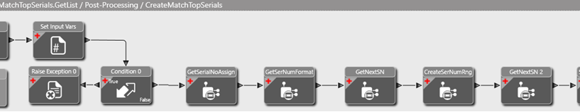

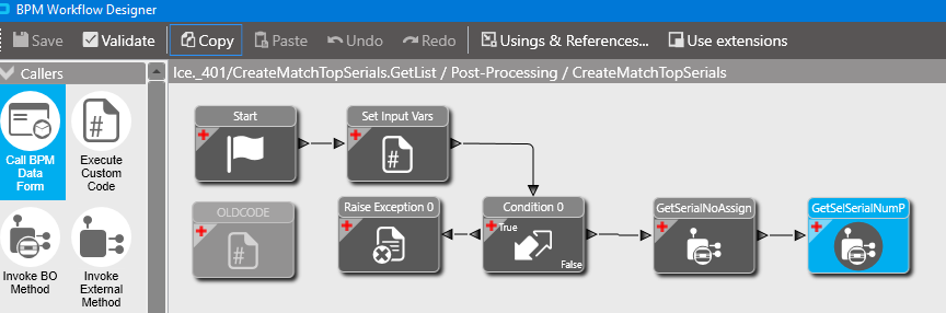

Hello @JasonMcD! Thanks for the help with your function library, I imported it and have been reviewing how you coded it and wanted to follow that same approach instead of all custom C# code.
So I did this:
And I get this error (which makes no sense to me since I selected the Tableset within SerialNoAssign):
There is at least one compilation error.
GetList.Post.CreateMatchTopSe.cs(34,31): error CS0433: The type 'SelectSerialNumbersParamsTableset' exists in both 'Erp.Contracts.BO.SelectedSerialNumbers, Version=10.2.700.0, Culture=neutral, PublicKeyToken=5d3fa3c7105d7992' and 'Erp.Contracts.BO.SerialNoAssign, Version=10.2.700.0, Culture=neutral, PublicKeyToken=5d3fa3c7105d7992'
GetList.Post.CreateMatchTopSe.cs(73,81): error CS0433: The type 'SelectSerialNumbersParamsTableset' exists in both 'Erp.Contracts.BO.SelectedSerialNumbers, Version=10.2.700.0, Culture=neutral, PublicKeyToken=5d3fa3c7105d7992' and 'Erp.Contracts.BO.SerialNoAssign, Version=10.2.700.0, Culture=neutral, PublicKeyToken=5d3fa3c7105d7992'
GetList.Post.CreateMatchTopSe.cs(325,78): error CS0433: The type 'SelectSerialNumbersParamsTableset' exists in both 'Erp.Contracts.BO.SelectedSerialNumbers, Version=10.2.700.0, Culture=neutral, PublicKeyToken=5d3fa3c7105d7992' and 'Erp.Contracts.BO.SerialNoAssign, Version=10.2.700.0, Culture=neutral, PublicKeyToken=5d3fa3c7105d7992'

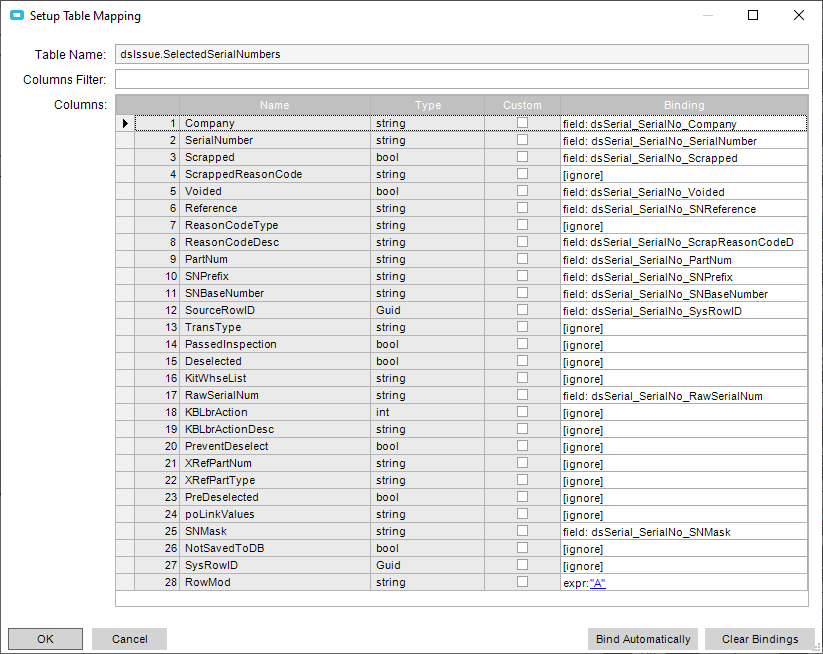

In the JSON you posted, the “SerialNoAssign” section had a RowMod item, but no value was assigned. It needs to be assigned “A” or “U”. I assume the “SNFormat” section will have the same issue.
I’ll stick my neck out here, but I think this is one area where the trace just doesn’t help. I had to go rogue and build on the work of others. Especially if you do widgets, the “Fill table by query” step is not in the trace but it is necessary. Again, I think because the actual Epicor dev team seems to have objects they use that we cannot.
Thanks for this! Totally missed that.
I updated the loop I have so now I’m setting RowMod = “A”, SNFormat in my tracing doesn’t have any RowMod set. However still I am receiving the same error after running. Gonna retrace my steps and see…
