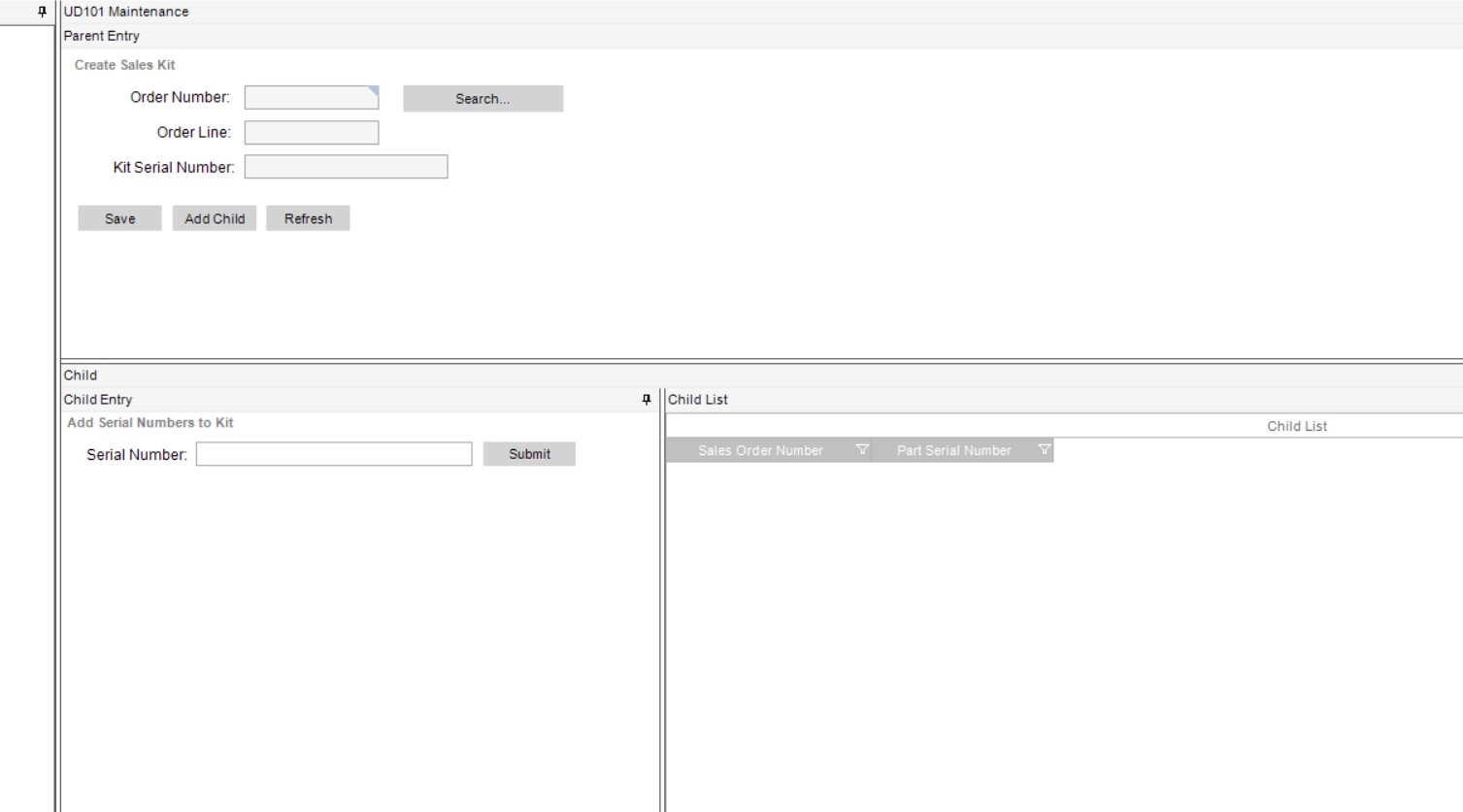

We have customizations around serial match using the built in functionality (Job Parts). the customization allow users to match Serial Numbers assigned to a Job, though based on what you are looking to do, this isn’t going to help; as you don’t want to track the serialnumber of a part the moment the part is received.
We also have created a customization for serialized kits. This sounds more like what you are trying to do. Scan a parent item’s serialnumber, and then scan all of the child parts serialnumbers. We use one of the parent/child ud tables to do this.
As you can see from the screen shot its very basic.
