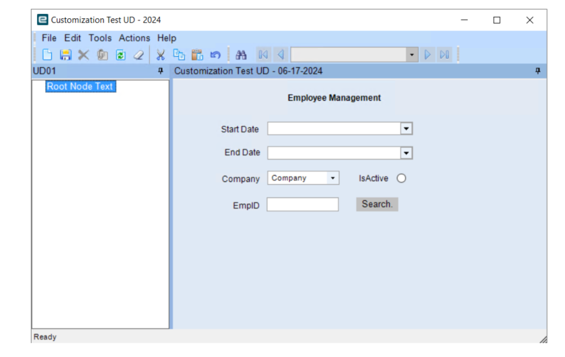

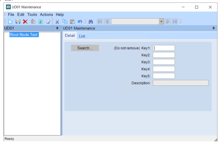

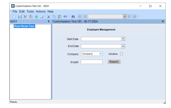

I managed to create my UD form in developer mode, but I still have a few issues that need to be resolved. First, how do I remove the text “Root Node Text”?
Second, when I save the form, turn off developer mode, and then try to open the form again, it reverts to the initial template. How can I fix these issues?
I’ve got a cut and paste solution. Un momento.
Okay
using Infragistics.Win;
    //Replace thisForm with Form Name
    CreateBlankForm(thisForm, "New Form Title");
public void CreateBlankForm(Form whichForm, string newTitle = null)
    //Change Form Title
    if(newTitle != null) whichForm.Text = newTitle;
    //Hide the top Toolbar
    baseToolbarsManager.Visible = false;
    //Hide the left side treeview
    ((Infragistics.Win.UltraWinDock.WindowDockingArea)this.csm.PersonalizeCustomizeManager.ControlsHT[whichForm.Name + ".windowDockingArea1"]).Visible = false;
    //Hide the right side dockable window.
    ((Infragistics.Win.UltraWinDock.WindowDockingArea)this.csm.PersonalizeCustomizeManager.ControlsHT[whichForm.Name + ".windowDockingArea2"]).Visible = false;
You have to assign a customization in Menu Maintenance, and restart the client.
