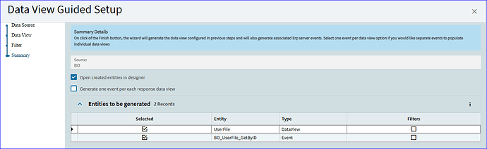

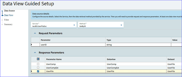

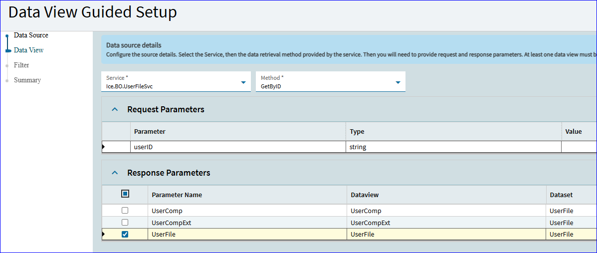

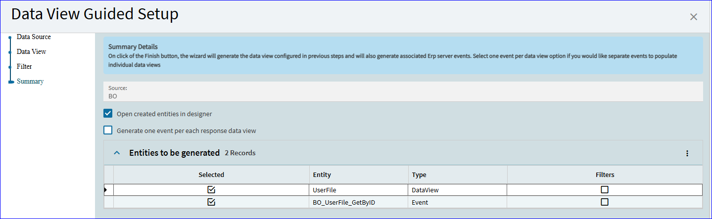

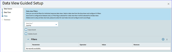

Add a dataview… Use the Guided Setup (Wizard). We only need the UserFile dataview, so you can just check that one.

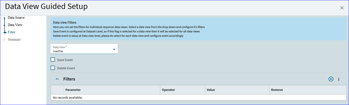

I wouldn’t check the Save/Delete options here… we have no plans to do either of those.
This will create the UserFile dataview and the corresponding GetByID event.

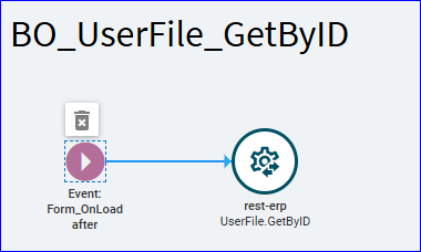

Change the trigger to after Form_OnLoad, or where ever you find an opening.

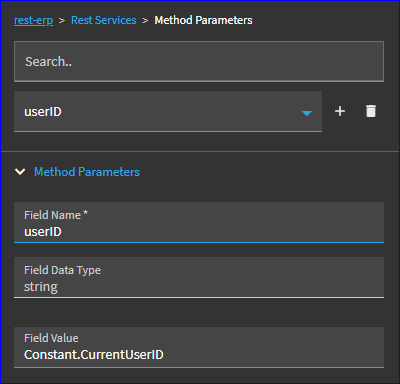

Rest Call: Just add the Field Value of Constant.CurrentUserID in the method parameters. You don’t need to make any changes in the request/response areas.
Preview… make sure your event fires and your UserFile dataview is populated.

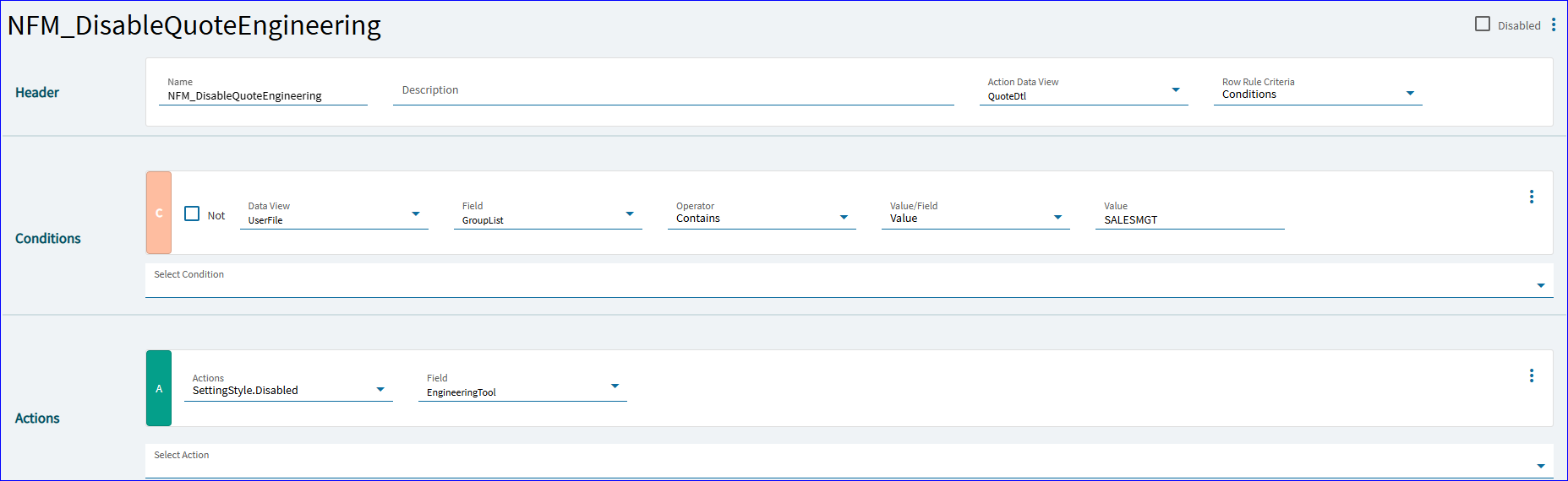

Enter the Data Rule:
YouWillSufferMe

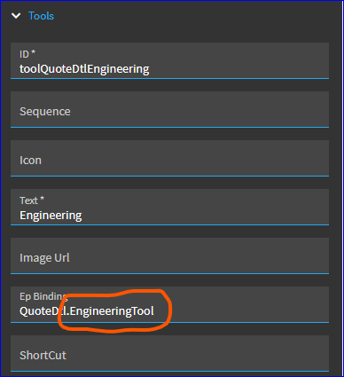

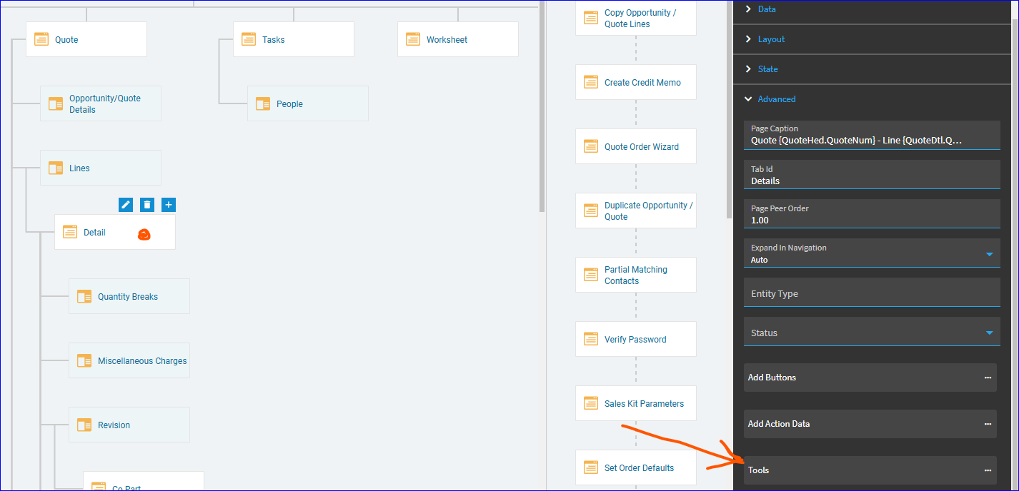

If you look at the page properties for the line “Details” page… scroll down to Advanced and jump into the Tools:
Scroll down to near the bottom of the list… you’ll see the toolQuoteDtlEngineering. And, luckily, it already has a binding we can use.
So, we now create a Data Rule, using QuoteDtl as our action view (since that’s where the target tool is bound).
Add a condition where if the UserFile’s (the new dataview we added earlier) GroupList (which is a delimited list of the CurrentUserID’s security groups) CONTAINS a value of the security group you want to use. Again, I have one called SALESMGT.
… Disable EngineeringTool (which is the column binding of the tool, circled above).

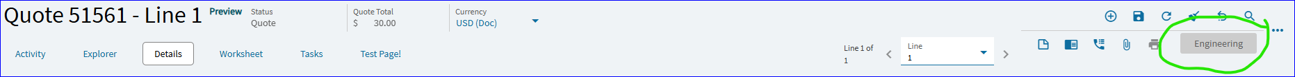

Result:
YouShallNotPass
NOW… one caveat. I was testing with myself… and I have the SALESMGT security group in my profile. But what I really want is to not let users who DON’T have the proper clearance to access the button.
So, go back to your Data Rule and add the “Not” criteria.

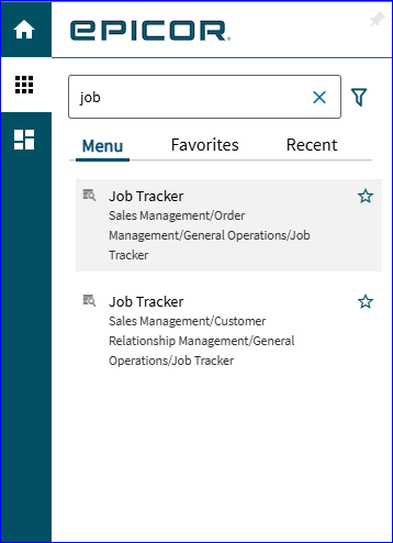

This test (sales) user does not have access to Job Entry or Job Manager:
Oddly, if this user uses the Context Menu for Job Entry, it will open it in Job Tracker (read only)… which is good. They have access to Job Tracker.

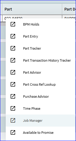

But the Context Menu of a part number ALSO includes the Job Manager option

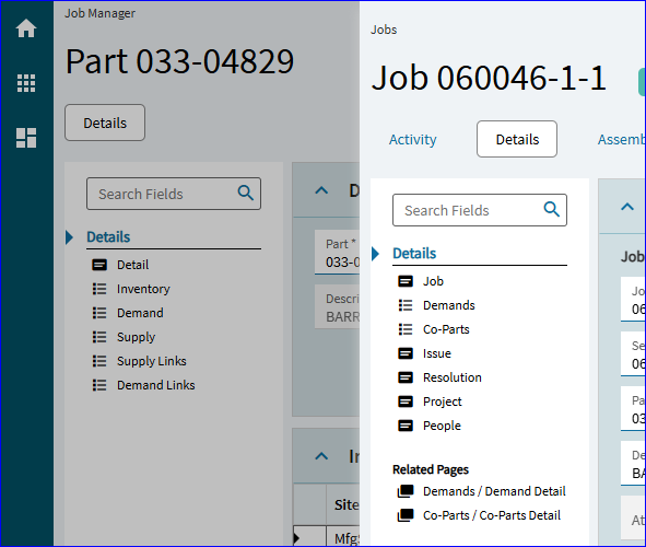

… And it will let them in to Job Manager!
Not only that, but from Job Manager… you can access Job Entry via slide-out panel! Fully active (not a read only tracker view)!
There are so many holes in Epicor security it makes your head spin!

One area we really want to keep people out of is Part entry. We have very ordered numbering process and specific Description naming conventions, not to mention Part UoMs get locked once there is a transaction on a part and you can’t deactivate them very easily until all records are processed.
In Quote Entry the context menu has Part Entry prominently featured :frowning:
