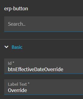

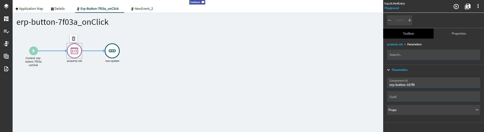

FWIW I also tried this yesterday. I iterated with several kinds of events, including simple buttons. I referenced using the button ID, and the GUID (Pulled from dev tools. How else am I supposed to find the GUID for a control?)

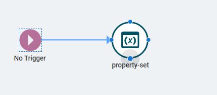

That property-set widget either doesn’t do what we think it does, or it needs some other widget after it to update the screen. I would love to hear a solution to this.

You definitely don’t need the GUID, but that’s how I find it too.
You can do it just fine with the button ID.

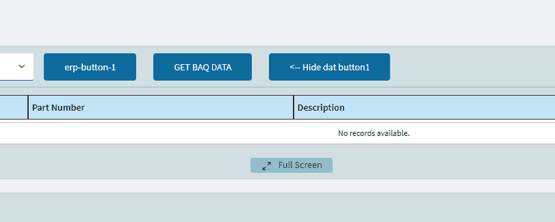

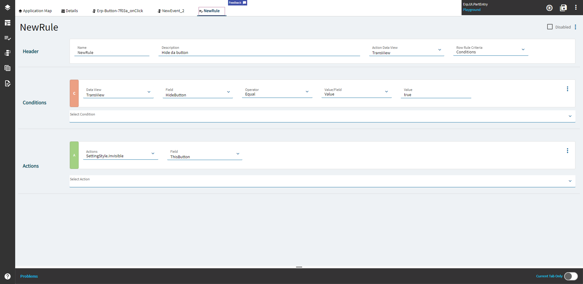

I don’t really know what your use-case is, but you can do this with a rule too.

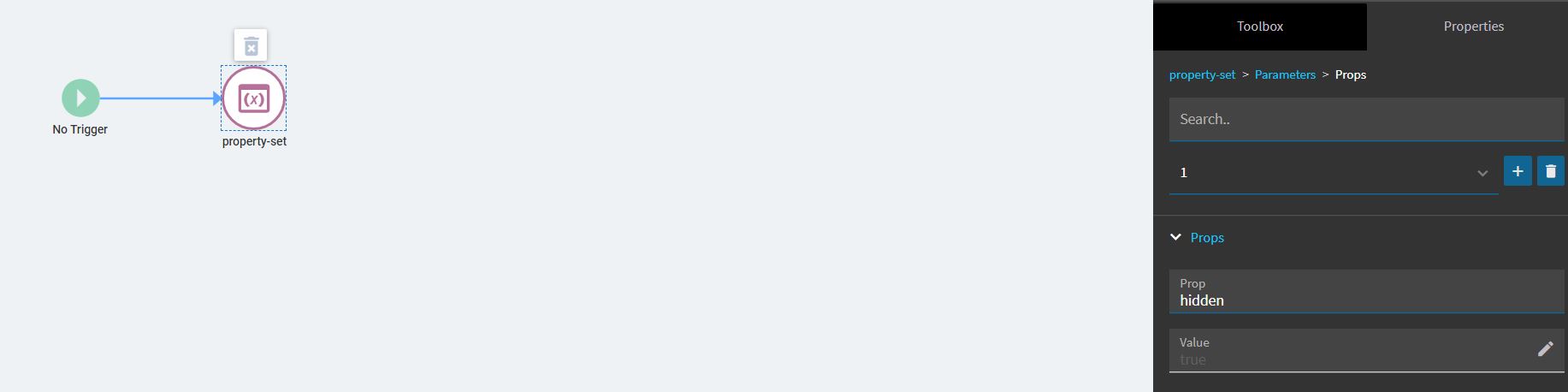

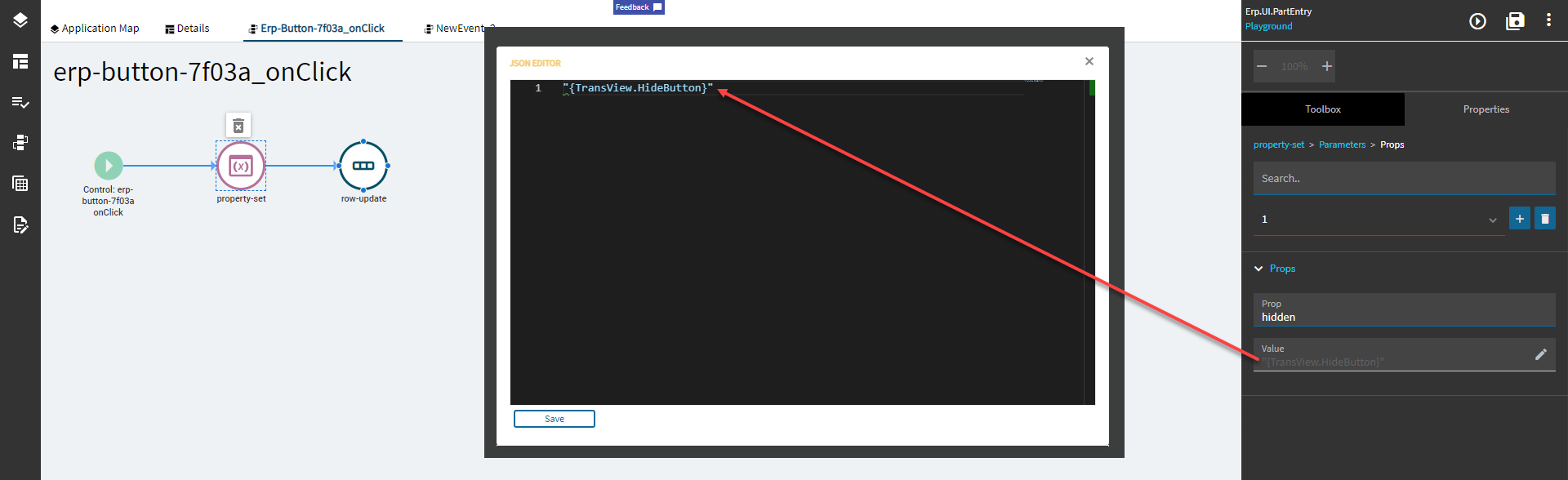

Using this event to toggle the TransView.HideButton, but you can base it off of any field.
Bind your button to something.
One rule to toggle them all.

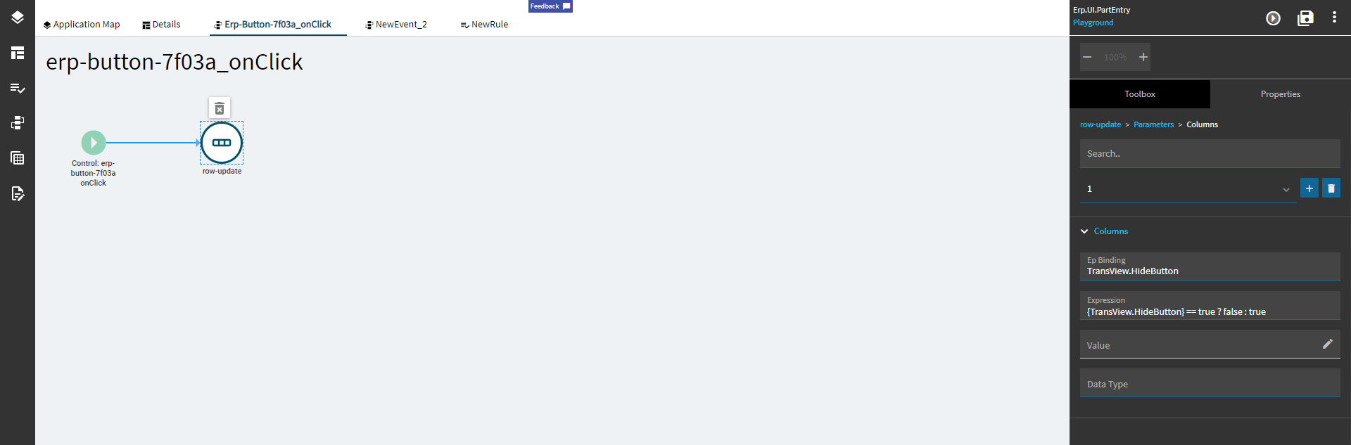

This approach worked for me. Just curious, what is this expression?
{TransView.HideButton} == true ? false : true
I don’t get it. Is the property set widget creating a new “HideButton” property in TransView? Is “HideButton” a built-in something? Why wouldn’t we use the property-set widget to set the visible property of the button? I mean it all sounds pretty straight forward until you posted this.
TransView is a runtime dataview. All I’m doing is creating an on-the-fly variable (HideButton).
That expression is changing the value of HideButton so it acts like a toggle. If it’s true, make it false. If it’s false, make it true. That way, when you click the button to hide the other button, you only have a single button to hide and unhide it, ya know?
In the example I posted your ARE using property-set to set the “Hidden” property of the button. I’m just setting that property to the value of TransView.HideButton to make it dynamic.

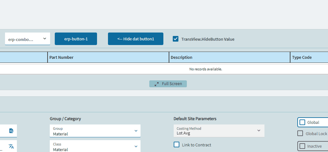

Again–without a use case, it’s hard to determine what y’all are trying to do, so I do my best to create an example with working pieces that show how it all happens.
I could have easily done something that sets the property if, say, ABCCode is “A” or whatever. I did the toggle button click, so everyone can see what’s happening in the GIF.
