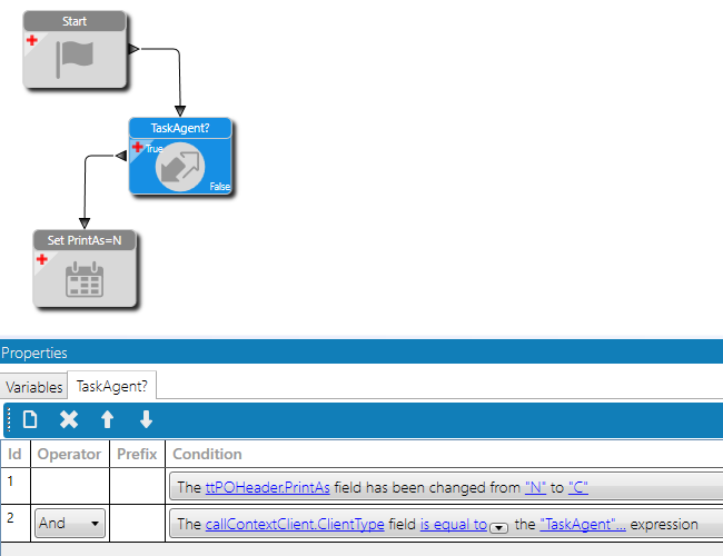

So instead of hijacking the RadioButtons, I decided to add a ComboBox and bind it to the DB field that the RadioButtons are associated with. I then create a ValueChanged event. this would allow me to identify if the user made the change and show a dialog screen to inform them of the change, per company request.
I create a Data Directive to deal with the change and reverse it if it was a system change.
