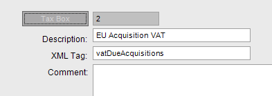

I’m assuming that the Electronic report is using the XML tags. Double check the setup on Tax Box Maintenance:
Hi
Yes Tax boxes all xml tags are selected
