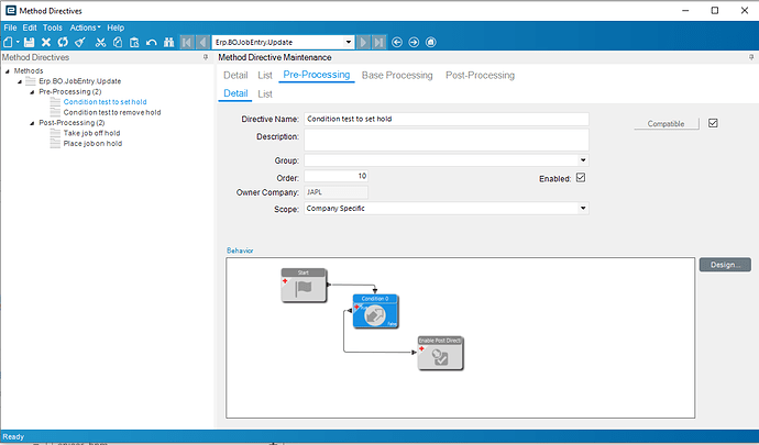

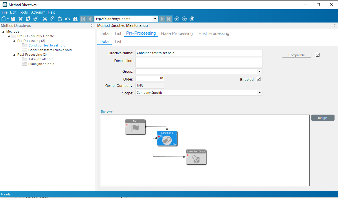

So following the similar steps to the ‘Business Process Management’ booklet, i’ve defined the 'Hold type maintenance, both pre-processing (i.e. for attaching and removing hold) in the ‘Erp.BO.JobEntry.Update’ along with both post-processing. Like shown below.

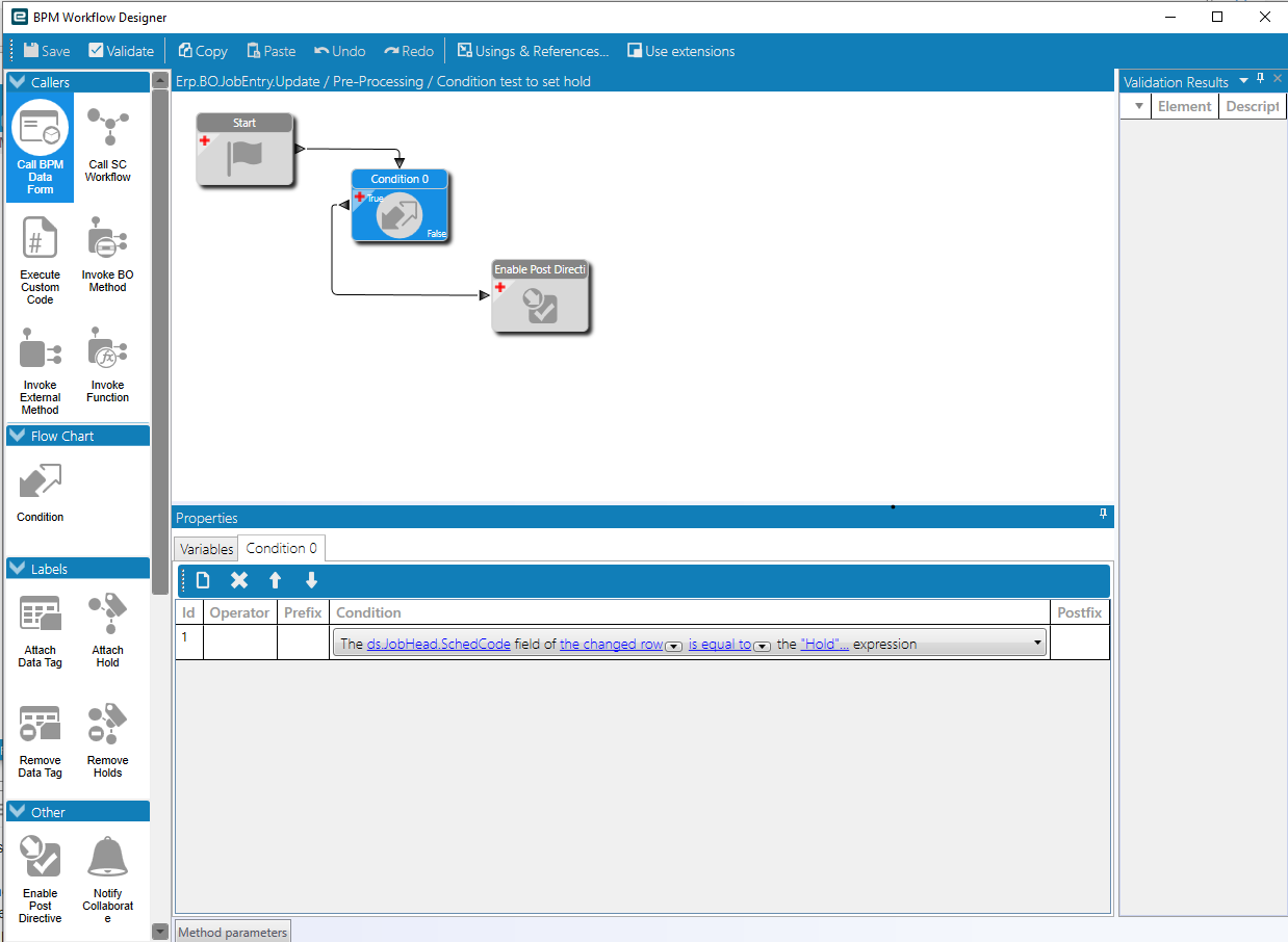

Below is the workflow designer for ‘Condition test to set hold’.
and similarly, we’ve designed for the rest of the processing.

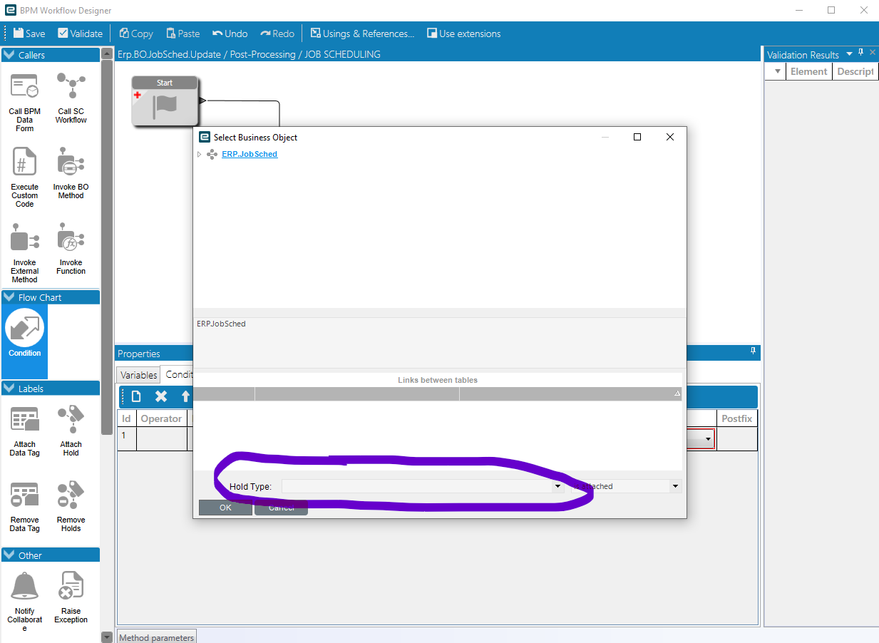

Now, If I go to ‘Erp.BO.JobSched.Update’ for applying that hold, in the below highlighted field should get populated, but it’s not happening. Does anyone can help me with that?

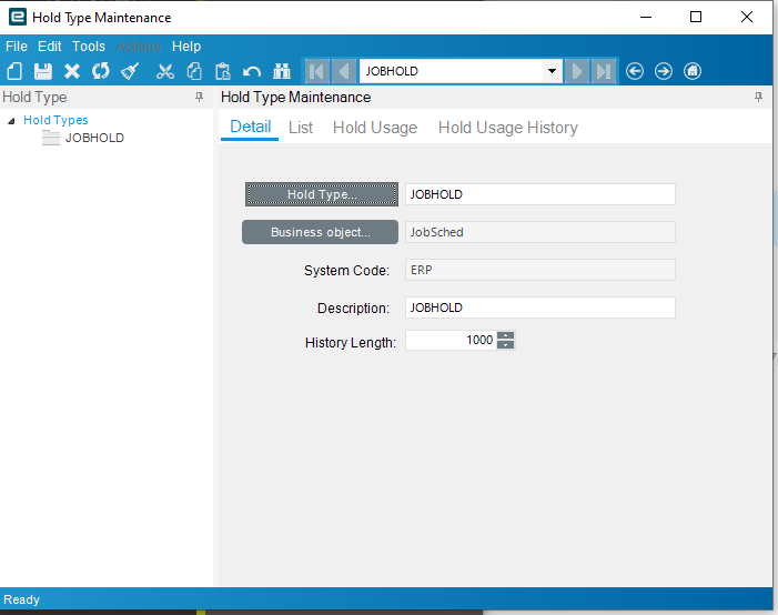

Did you create the hold under Hold Type Maintenance?
yes I did
How does your hold type looks like in Hold Type Maint?
It looks like this
