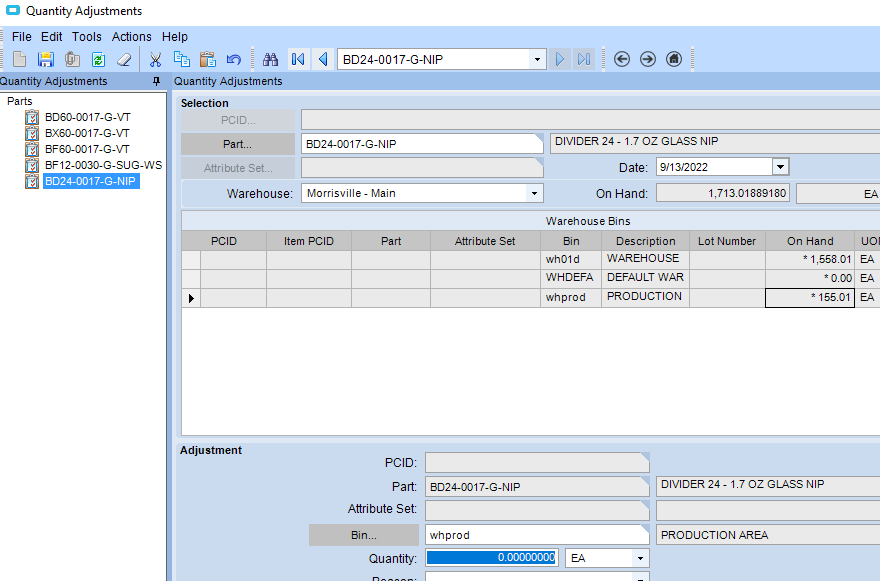

I tweak the decimal places on the UOM and do quantity adjustments using the DMT to remove these. Dont forget to set the decimal places back after!
We run into this occasionally as well as we have components that we issue small fractions of (i.e 1/60th), but the base UOM is eaches. I set the number of decimals for the ea UOM to 8 and then can make the adjustments right in the base quantity adjustment screen.
