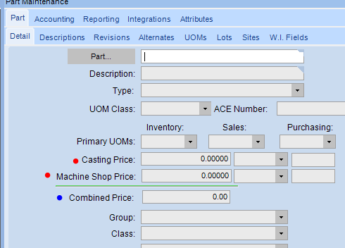

How can i add an expression/calculation to a Part Maintenance field?
I am trying to add a field (Combined Price) into the part master that would be the sum of the Part.UnitPrice(Casting Price) + Part.InternalUnitPrice (machine Shop Price) but i cant figure out how to add an expression or how to edit the script editor to accomplish this.

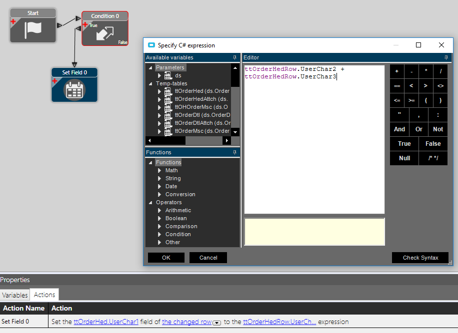

No worries Joe, you actually shouldn’t need to write C# for something this simple. There’s a Set Field module (or block or whatever those icons are called) you can use to set the field of the updated row to an expression. You may also want to consider expanding the Condition statement to include added rows so any new rows with those prices will trigger a calculation. Then here your Set Field would use 'set ___ field of the CHANGED row…", Example Below:

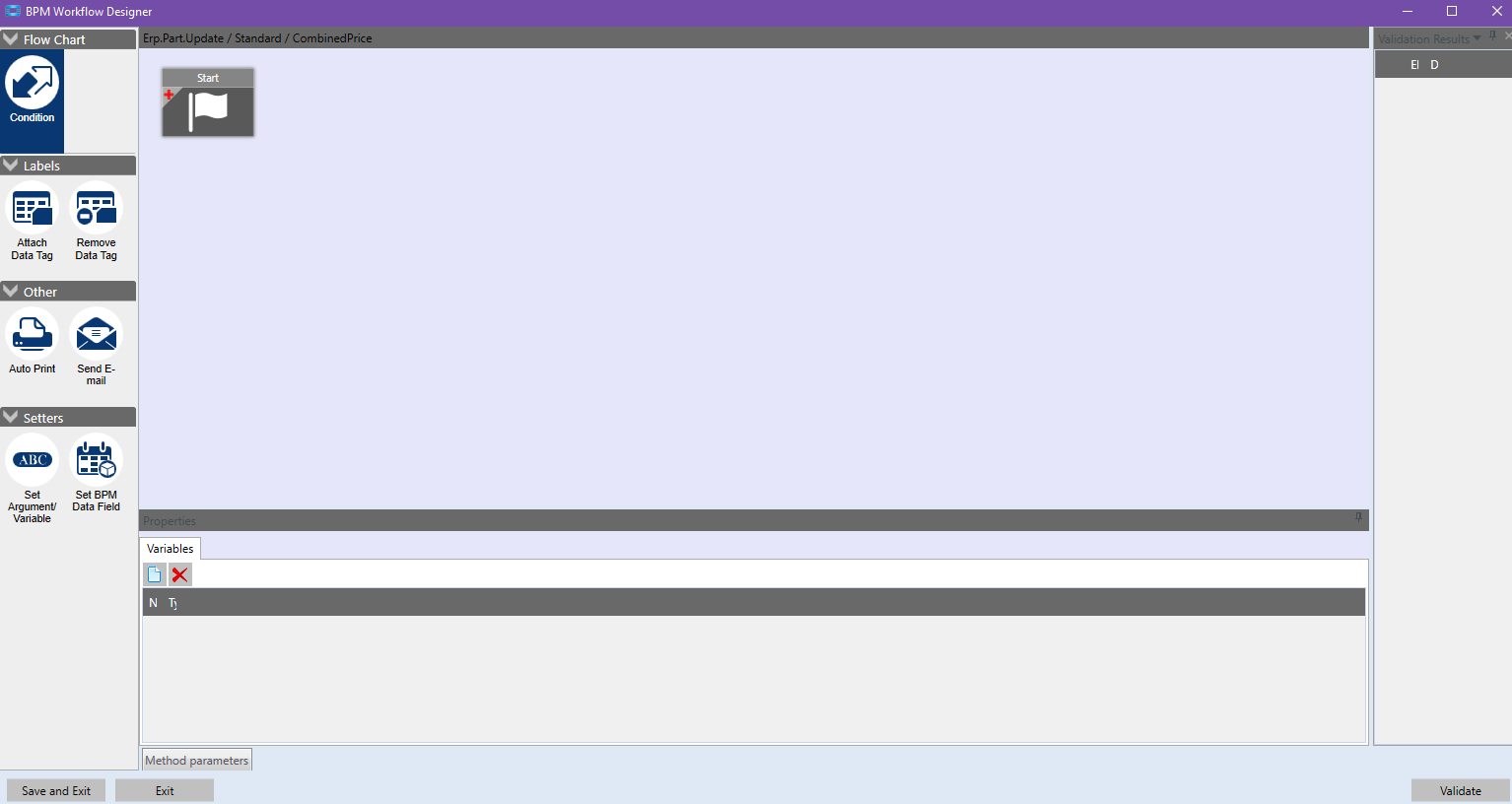

Either im missing something or a new version has moved the module but im not seeing an option to drag over the Set Field module. The only one i have is set BPM field but that shows different options as shown in the pictures below. Im signed is as the admin so i cant imagine this being a security issue. for the record we are running 10.1.600.7

Ah ok your problem there is you’re using a Standard Data Directive. What you want to use is a Pre-Processing Method Directive. You should see Set Field in there on your version.
If you have an Insights booklet for any of the BPM courses they have a pretty good description of the different kinds of Directives and the different between Standard vs In-Transaction Data Directives and Pre-Base-Post-Processing Method Directive. In general though, use In-Transaction for Data Directives and use Pre/Post Method Directives. Standard DDs and Base MDs are special.
