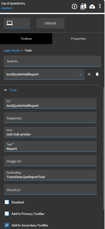

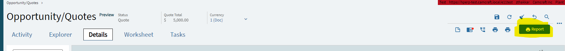

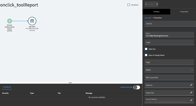

created new tool icon - Report
now trying to add new event onClick when click on report icon generate SSRS report for quote num. which event trigger i can use for it?

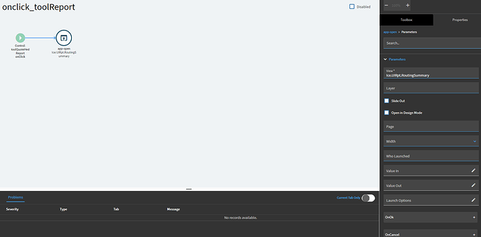

Your trigger will be onClick of your button… and then do an app-open for the report.
app-open Parameters:
The “View” will be the menu of the report, for example:
Erp.UIRpt.QuotForm
or…
Ice.UIRpt.MyReport
You’ll also have to figure out the “Launch Options” to pass information to the report automatically (if desired). For example, if you’re printing a quote document, you probably want to pass the QuoteNum.

No, you don’t have to create a new view. The “view” should match up with whatever the kinetic application is for that report (assuming you generated the application already).
Below are the “Launch Options” for the standard quote form. You could start with that and alter as necessary. Not knowing your custom report, I can’t say what values it may be expecting.
	"type": "Ice.Lib.Framework.LaunchFormOptions",
	"options": {
		"currentVal": "{QuoteHed.QuoteNum}",
		"valueIn": "{QuoteHed.QuoteNum}"

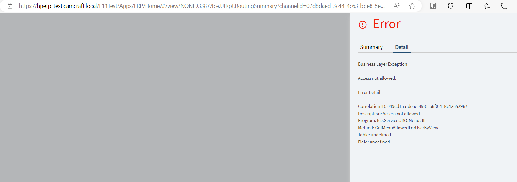

when i added Launch option and i got the below error, is there anything I am doing wrong?
My apologies, I’m getting a little lost now. Is this a NEW report? or something that you’ve been using already in Kinetic?

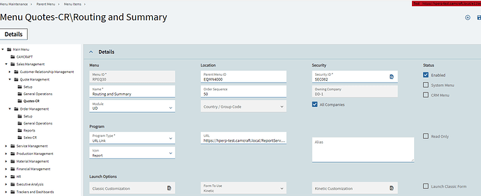

I added that report link in menu maintenance.
once i added link in menu i got report in epicor see attachment

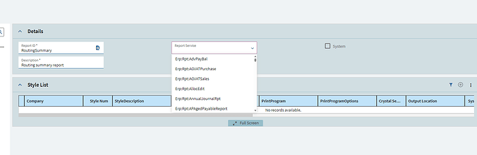

now i am trying to add in report style , for that what will be the report service?
please advise and thanks for the help.
Can you run the report via your menu?
yes i can run that report.
