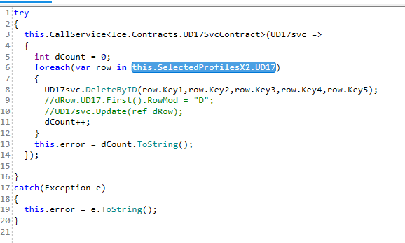

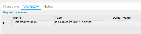

I have a function that expects a UD17 table set, which is basically a set of records that need to be deleted:

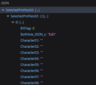

The code tries to access SelectedProfilesX2.UD17 but application studio is sending SelectedProfilesX2.SelectedProfilesX2 instead of SelectedProfilesX2.UD17
How do I fix this?

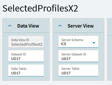

I have my dataview setup like this:

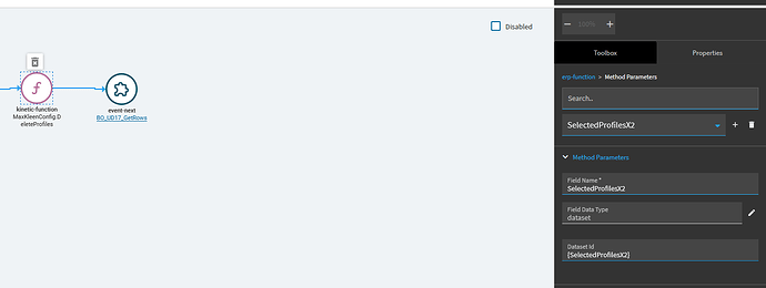

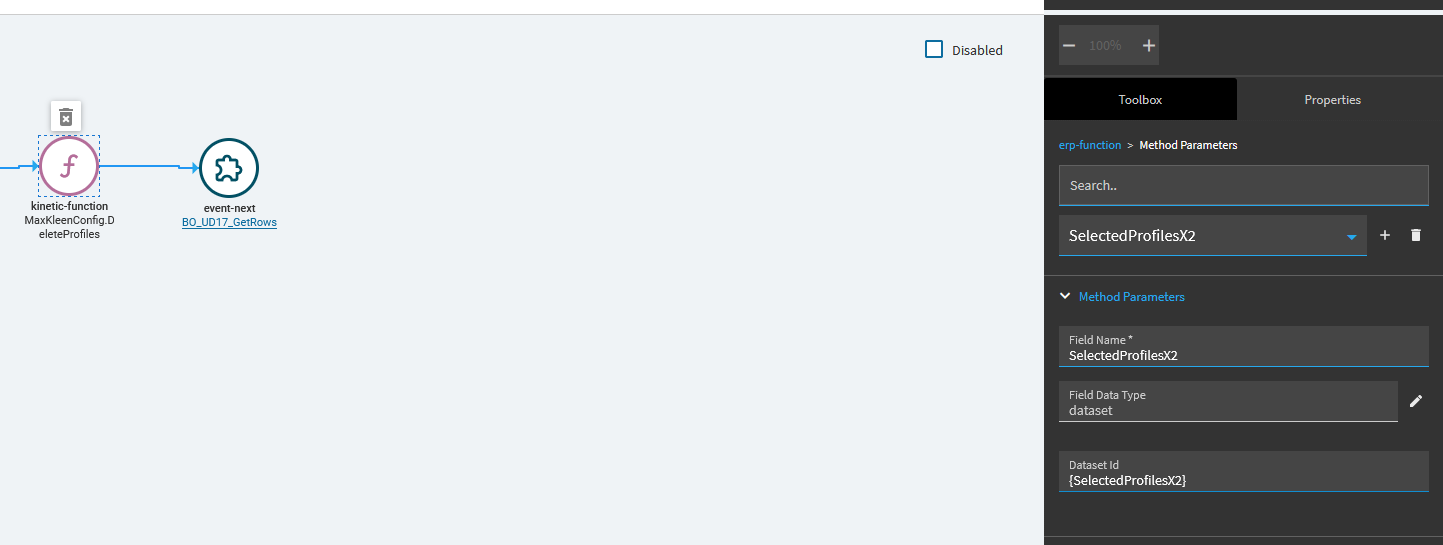

And the function call set up like this:

Yeah it’s hard to explain. It’s like the function parameters are one level deeper than it needs to be. My issue was related to sending parameters to a BAQ.

Can’t, its getting the name from the dataview name, and I already have another dataview called UD17 that I don’t want to send.

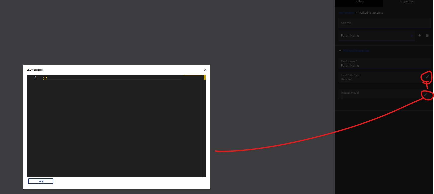

Have you tried providing your own dataset model? Click on the edit button beside field data type. Just stumbled on this
I saw that as well but I haven’t been able to figure out how to work it to do what I need. I think I would have to put {Mydataview} in at some point but that serializes the whole thing with the dataview name, and I would need just the children if I was going to use that to ‘rename’ the input.
Yeah, this is the exact struggle I was having. I don’t think there is a way as of this version.

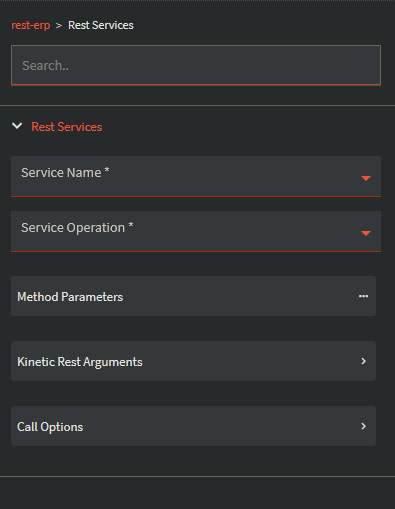

I’m mobile at the moment so can’t reference on the computer and get screenshots and stuff, but if you use a kinetic-rest widget and populate the function library field appropriately, and put the function under.. method I think? You can then set up rest request parameters, from there you can have input dataview name xxx, parameter name to send yyy, that should work.
So service name would be the function library and service operation would be the function? And then instead of using the Method Parameters I would use the Kinetic Rest Arguments?
