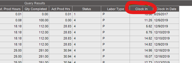

How can I convert Labor Clock In Time to 12hr format
I am trying to convert the clock in time to a 12hr format. For example, on the second record, in my screenshot, 11.25 should equal 11:15 AM.
Any ideas?
Thanks!
