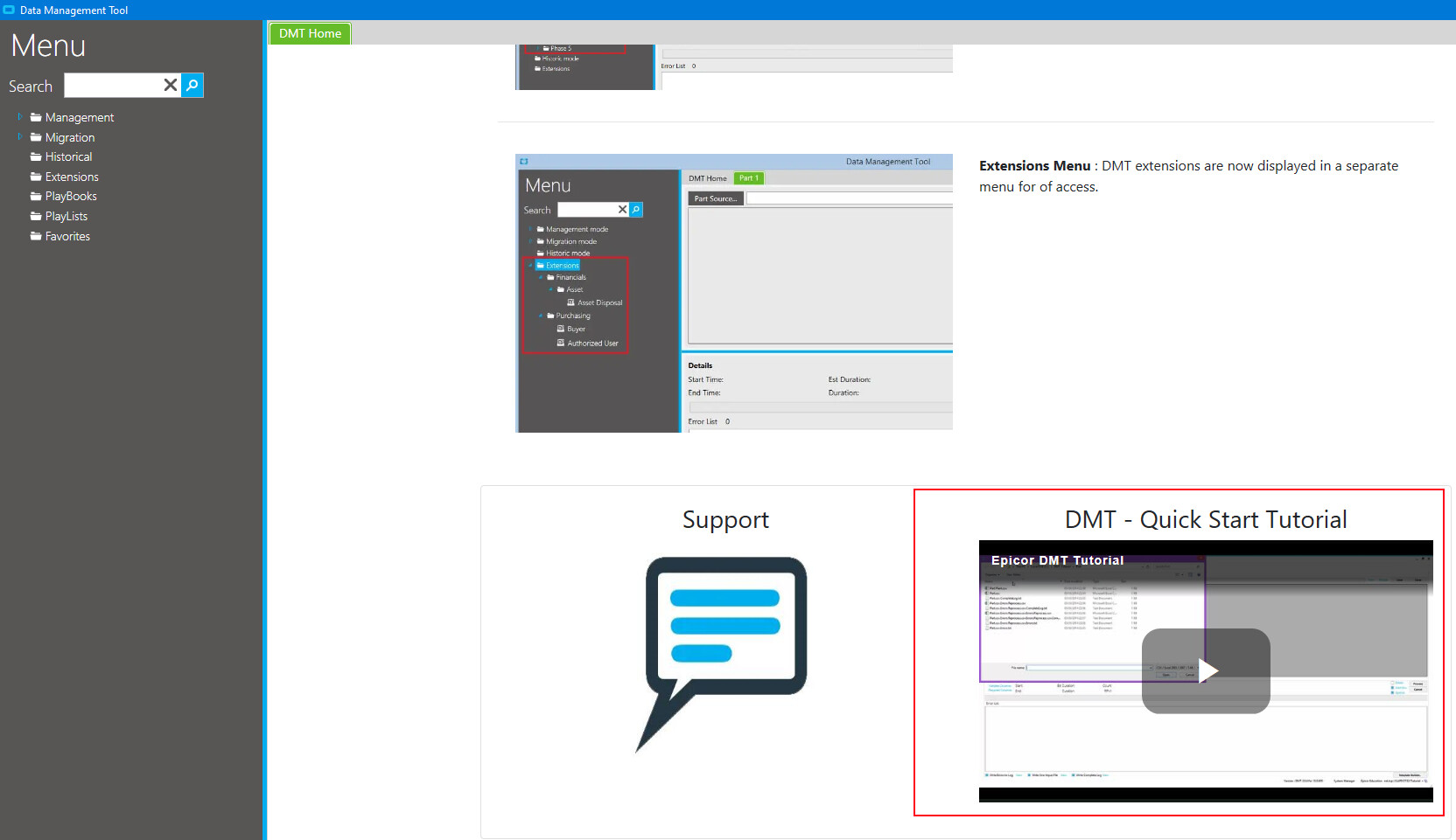

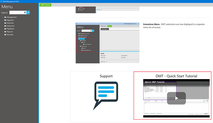

@iggy - Hi Iggy, where do you see the DMT videos? im running 10.2.700.5 but do not see them
I don’t know if it’s in .5, I am using .10, but try this
C:\Epicor\ERP10.2Client\Client\DMT.EXE, from your local machine, not the server (but it may work on the server)
when you log in, you will get a screen like this if you scroll to the VERY bottom, click on the DMT - Quick Tutorial (they use Quick, loosely)
@iggy … Thanks, found it
awesome. happy I could help you. Get ready to be bored silly haha. Great information though.
