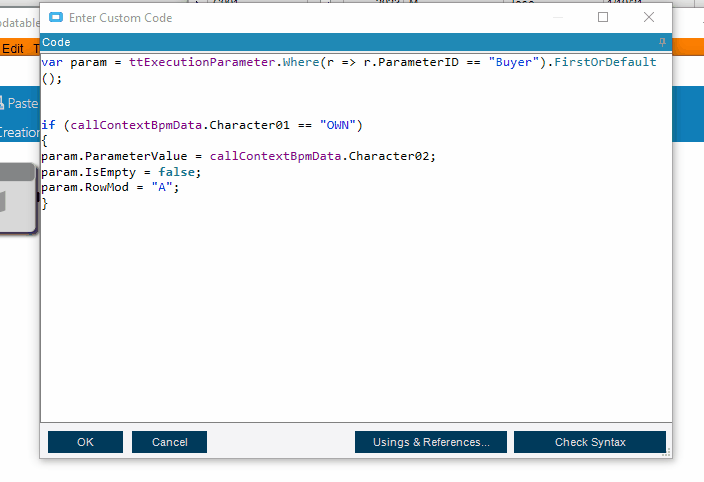

var param = ttExecutionParameter.Where(r => r.ParameterID == "Buyer").FirstOrDefault();
use the name of your parameter and this should get you the parameter. I pulled this from where I am setting the parameter in code, but it should pull the parameter that was set as well.

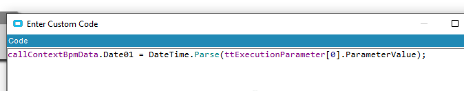

So the execution parameters are available on the get list method, so what you can do is set one of your BPM Context fields in the get list post processing, then you can use the BPM call context fields in your base processing.
Set this with post processing BPM on get list.

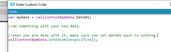

Then on your base processing on Update you can use this.
