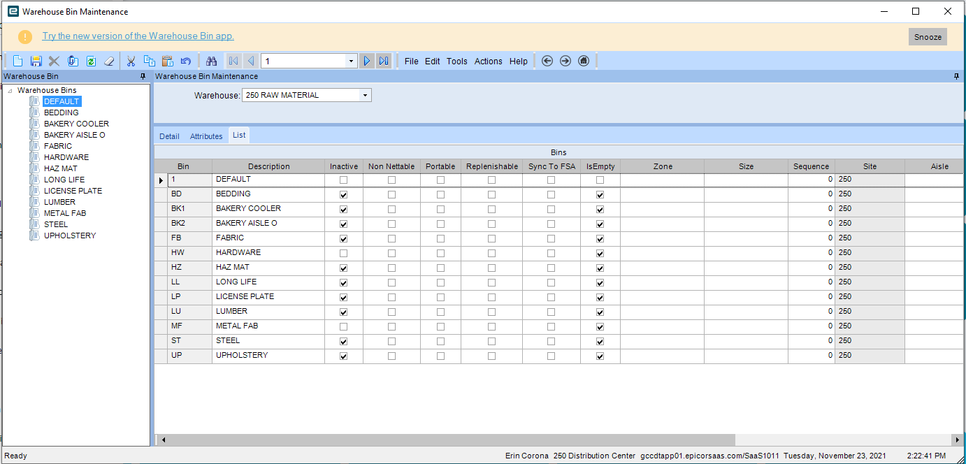

How can I make a bin inactive? - Need to find which part is using this bin as Primary Bin
I’m not trying to delete the bin numbers - I just want to inactivate them. When I try, I get the error saying, “Cannot set as Inactive. Bin is set as Primary Bin for a part.”
I have tried running BAQ’s on the following tables: WhseBin, PartWhse, PartBin, PartTran, and PartBinInfo.
The PartWhse.PrimBinNum field I’d like to use is an external field. I don’t see any part with a Primary bin as anything other than 1 so I don’t think I’m querying the right fields. I’ve tried so many combinations now I’ve lost count.
I know you can’t inactivate a bin if it has any on-hand quantity, but the IsEmpty field on Warehouse Bin Maintenance shows both these bins as empty, so I think I’m good here. The error is pretty specific, so it’s got to be the primary bin set for a part, but which fields should I be using to query that?
