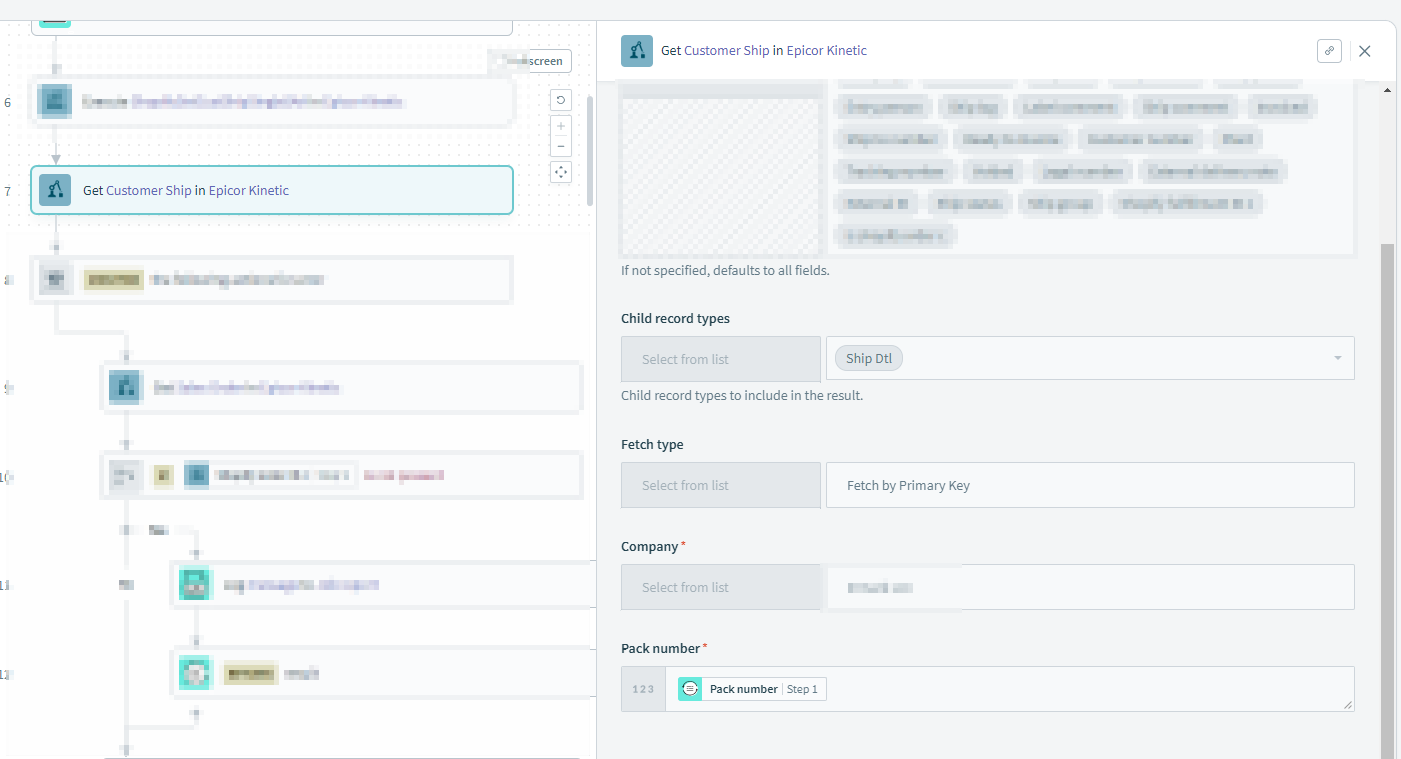

Is there a way to explicitly set the site context in your kinetic connector? In the connector setup and also in the individual “action in app” step I can set the company but not the site. There must be a way?
Site usually shows up on each widget under the additional fields section
What widget are you not seeing it on
It doesn’t matter for a lot of record types but for cust ship if you are in the wrong site context you get record not found.
You’re right its tucked away there under Optional, thanks!
